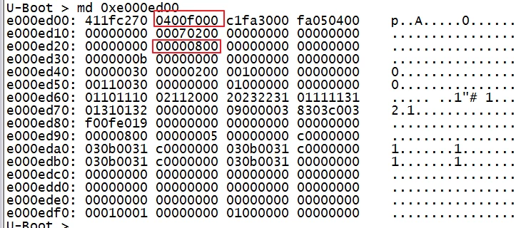

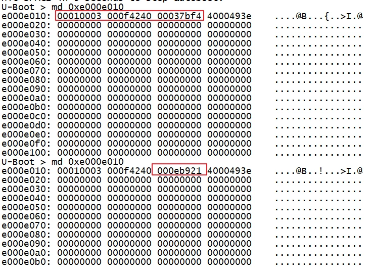

I ported u-boot 2018.03 to my own board based on stm32f767igt,i set some register with systick timer as below:
as the above picture, the systick timer count is changed,but i couldn't get in systick handler?besides register on 0xe000e010,is there some other registers will influence systick timers performance??I get confused ...

    Posted on March 23, 2018 at 13:59
    Vector Table Address
    Entry in Vector Table
    Other interrupts with higher priority blocking
    System Handler settings in SCB
    Interrupts Disabled

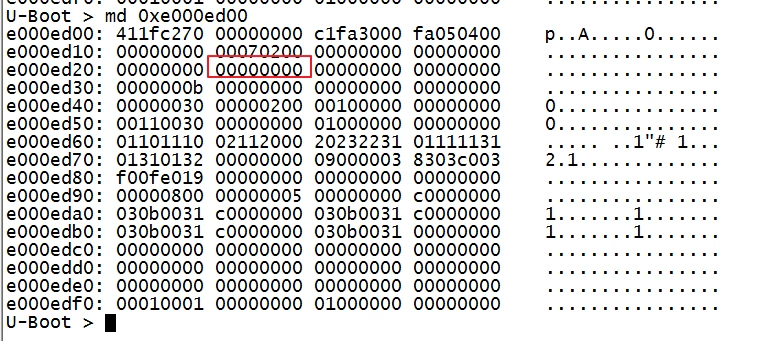

    I solved this problem,as your advice .I check my scb relate register status :
    i find systick is always pending , then i thought my systick handler function waste too long time ,so i remove much codes in the handler.then i found it's still pending,after i check shcrs register, i notice i set bit 11 before.after i remove thie code,the handler is ok.no pending as below
