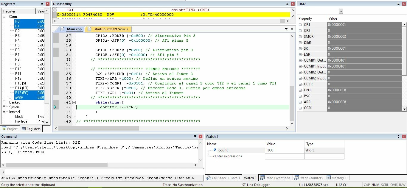

Hi, i'm using my STM32F7 nucleo 144 and i'm learning about timer encoder mode and i follow the example in the datasheet but when i check the CNT register it oscillates in the same values and if i use the A0-A1 pins the encoder works bad, can somebody help me please?
// ******************* PORT ****************
	RCC->AHB1ENR |=0x03; // Turn on A,B clocks
// ******************* PINS *****************
	GPIOA->MODER |=0x800; // Alternative A5
	GPIOA->AFR[0] =0x100000; // Alternative function AF1
	GPIOB->MODER |=0x80; // Alternative B3
	GPIOB->AFR[0] =0x1000; // Alternative Function AF1
// ******************* ENCODER TIMER********
	RCC->APB1ENR |=0x01; // Turn on the TIM2 clock
	TIM2->ARR =1000; // Maximun count
	TIM2->CCMR1 |=0x0101; // select TI1 and TI2
	TIM2->SMCR |=0x03; // Encoder mode 3
	TIM2->CR1 |=0x01; // Timer On

waclawek.jan
June 1, 2020
Which 'F7?
Read out and check the GPIO registers content, in debugger. In debugger, observe the given pins' GPIO_IDR bit, if it changes according to the input signal. Check (using the Nucleo's User manual), if on the board there's nothing connected to given pins.
Do you mean PA0 and PA1? What exactly do you mean by "works bad"?

I use the STM32F746ZGTX, and i check the GPIOA->IDR register in the debugger like you told me and it is strange, if i don't touch the encoder the PA1 pin oscillates. i wrote that works bad and exactly is that, when i move the encoder, for example 1 step in the debugger the cnt change 3 steps or 2 steps
Yes, but that's really what's happening on the encoder's output, isn't it.
Use an oscilloscope to observe the encoder's behaviour.
1 step of what? You mean 1 detent on encoder intended as manual input? Those tend to produce a full four-quadrant signal upon moving one detent, so setting timer to count on both edges, it may quite well be that each detent increments the counter by 4.

Thanks, when i conected my osciloscope i watched the proble, it was the cable between my encoder and the stm. if i move the encoder, the stm recognize it and the direction is correct. most all was perfect the "problem" is the value of the CNT register. I move my rotative encoder 1 step (my encoder is the 20 steps) but the CNT count 4 steps or 3 steps. i putted diferents values of the filter, the prescaler but always the CNT count the same values (3 steps or 4 if i move just 1 step in my encoder)
