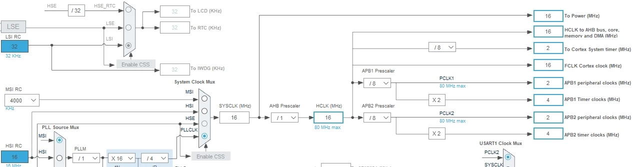

Also, read out and post RCC and FLASH-relevant registers content, to have some firm base for further discussion. For what I take from
>>> SystemCoreClock is 16 MHz and TIM17 is clocked at 4 MHz.
 >>Are you sure?
> Yes
it means that APB on which the timer sits is clocked at 2MHz, i.e. 8 AHB cycles per one APB cycle, correct?
Then read section from my post above above, containing "... accessing registers in timer (i.e. through the /4 APB bus) impose delays ..." and the post I've linked there.
arnold_w
arnold_wAuthor
Senior II
Feb 16, 2022 4:19 PM UTC
These are the clock settings I'm using:
This is my code when I sample TIM17->CLK asap in the interrupt routine:

waclawek.jan
waclawek.janBest answer
Feb 16, 2022 4:45 PM UTC
> I don't make a function call inside the interrupt routine, timerCntValue will be assigned the threshold
> TIM17->CCR1 plus 5 timer ticks.
So 20 system clocks. That's consistent with 12 system clocks of ISR latency + 2 system clocks to load r3 and r1 from FLASH + (0..7) + 8 system (AHB) clocks to get through the AHB/APB bridge with APB running at AHB/8 in order to load r0 from TIM_CNT. Give or take a couple of clocks, for I don't know exactly how things are synchronized.
