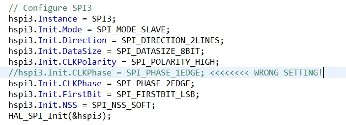

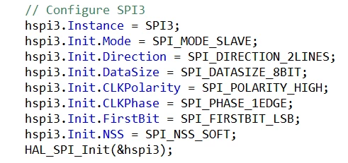

I have been trying to configure the STM32F407VE as a SPI slave. My first time configuring a SPI device ever so its all new to me. You can see my SPI settings and code as an attachment.

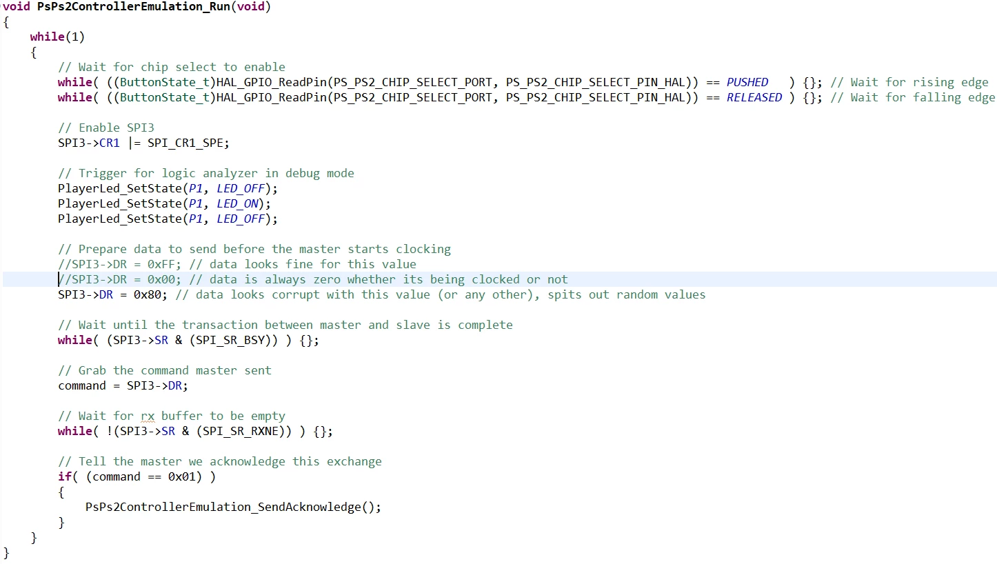

I am using software SS as I only have one slave and one master. Though I am polling the SS line of the master device to make sure I sync up okay as I best as I can before I only react on the master's clock signals later.

Now whenever I grabbed a byte from the master, I send a dummy byte of 0xFF to the master (full duplex). When i try to send any other value as the dummy byte, the MCU sends completely random values. There is no rhyme or reason I could find in the few hours of debugging.
I believe it has to be something wrong on how I send the byte but I think the order of actions I have makes sense as far as I concluded from reading the reference manual. Then again I am new to SPI congfiuratoin so I think there still might be an error

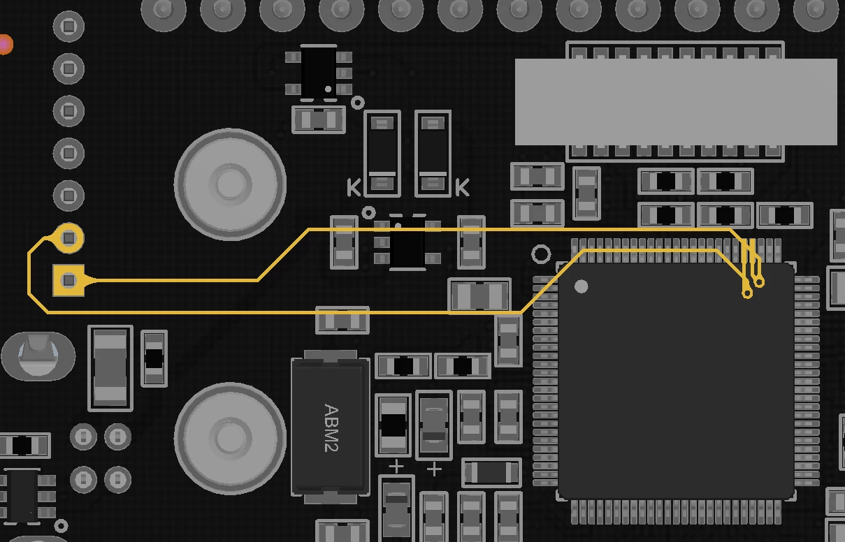

5) To see data line routing on my PCB, it is attached but I think it looks okay.

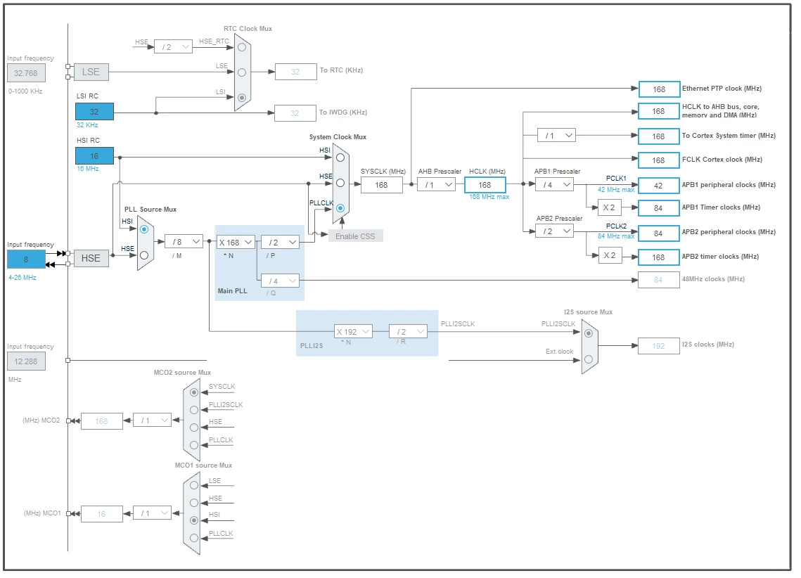

6) Clock tree is attached.

I think I found the issue, I had the wrong setting! I am going to play around with some more to make sure but the data looks better now.

Thanks for the answer! I am not well versed in interrupts or DMA so I went with polling the CS line. I do react fast enough to it I just don't understand why the data is random when I throw some data into the TX buffer.

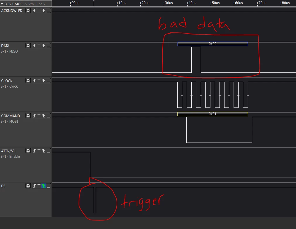

For example, attached is a screenshot on my logic analyzer. The bottom most pulse is my trigger and shows me where I start to react to the chip select. I have some time to load data into the TX buffer. Here I wrote 0x01 but the data is non-sense when it actually transmits.
