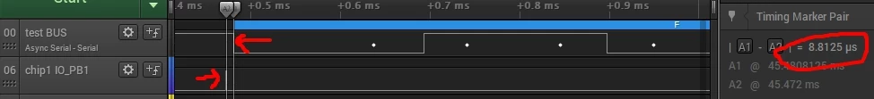

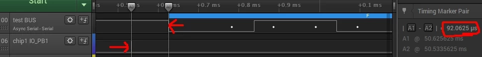

why is there a delay between (DR register written) and (data really showed) in UART on STM32F103CB?
I'm curious about the delay time between the title mentioned, I toggled an IO when I wrote data into UART->DR, the delay time varies from 3 micro seconds to 10x micro seconds

I'm not sure whether the time jitters is related with BAUD rate 9600(104 micro seconds/bit),
Isn't the data should be showed immediately when DR register written????
And why isn't the delay time all the same(or close)?

I think the shift register is clocked by the baud rate generator. So the transfer from the DR to the shift register is clocked by the baud rate generartor not the bus clock.
Hence the delay from 0 to 1 bit time.
