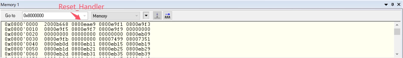

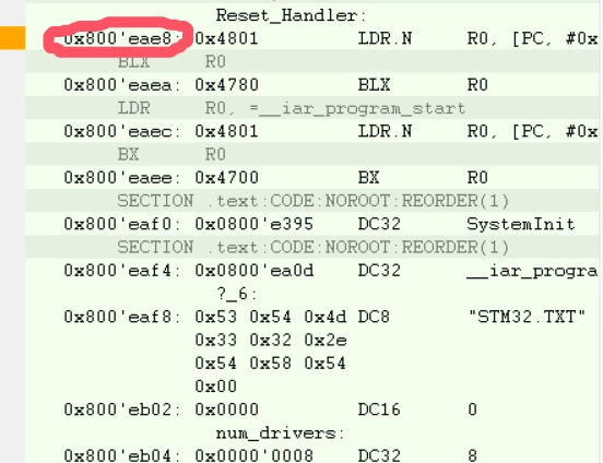

Why is the function address in the vector table offset by 1 byte from the actual function address?
Such as the title,why is the function address in the vector table offset by 1 byte from the actual function address?
In the vector table:
Actually:
and
This makes me wonder.

Just an artifact of thumb instruction mode. The LSB is treated as a flag, rather than as a part of the address.

Your answer has given me great inspiration!Thanks!
