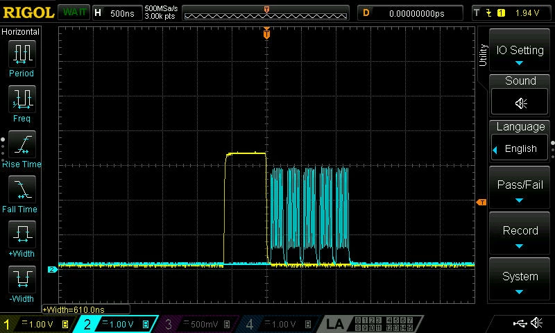

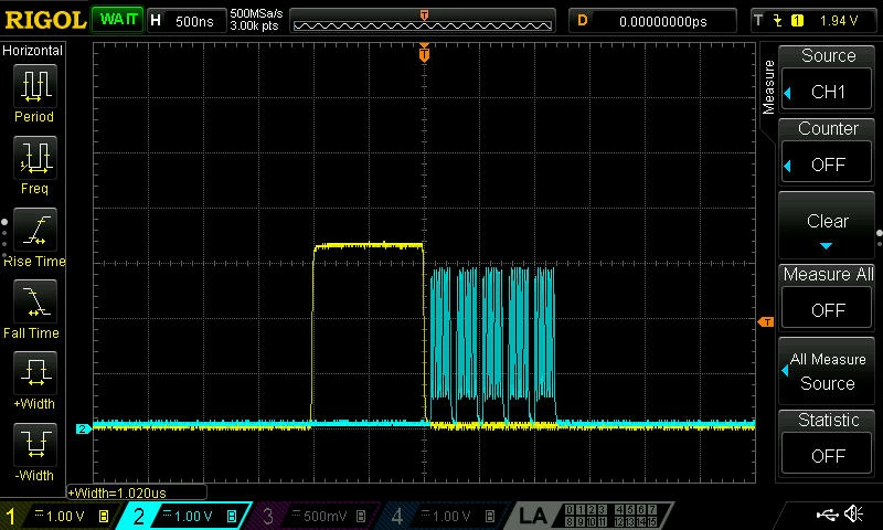

when taking the duration of the whole code, it is taking around 1uS as shown below.
CH1 (yellow) = GPIOA5
CH2 (blue) = SPI clk
Why is it taking around 1uS to execute these codes?

Yes, these codes where in GPIO interrupt.
When I checked the codes again, I forgot to remove the "first" GPIO set high so it measured also the GPIO interrupt flags.

 After removing it, it went down to 600nS, which I think is still quite long.

Okay, I dug out my Nucleo STM32G431RB and made some tests with gcc and 170 MHz core clock. In Debug mode, 194 clock cycles, in release with -Ofast and minimum debug info (-g1) 47 clock cycles. The first figure matches about your observed 1µs.

Hi I am using NUCLEO-G474RE @ 170Mhz and found some error in the code which made the measurement include the the clearing of flags in the GPIO interrupt (shown above).
After modifying it, it went down from 1uS, it went down to 600nS which I think still quite long.
I did also Release compile (select Release under the Hammer button), but still get 600nS. Not much difference bet ween Release and Debug compile.

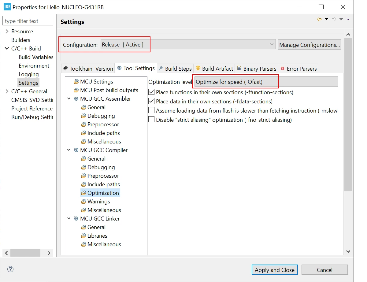

I am quite newbie in this optimization settings, can you show where can I modify it?
KnarfB
Jul 18, 2020 5:55 AM UTC
in STM32CubeIDE menu: Project > Properties > C/C++ Build > Settings
Also be sure that you have a separate Debug+Run configuration loading the release code (.elf) to the board.
