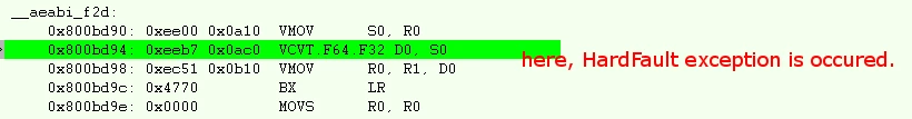

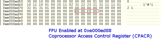

ex) When compiled with IAR 8.30.1, HardFault exception was occured.
float gfSetDataRate = 100.0f;
printf("Data Rate = %f \r\n", gfSetDataRate);
HardFault is occured at VCVT.F64.F32 instruction.
I also tested following case
  1. In case Compiled with GCC, is working well.
    1. Other device STM32F411, Working well with IAR, GCC.
What is wrong? IAR, my source, STM32F407 FPU?
Ggive me any other hints, please.

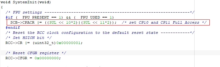

    Check the FPU is being enabled, usually in the SystemInit() code, and being called from startup.s

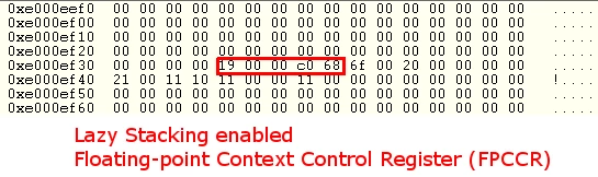

    And, as attached picture, exception is occurred at execution of FPU instruction, vcvt.f64.f32,
    I thought that this may be related with lazy stack. so, now reviews the lazy stacking.

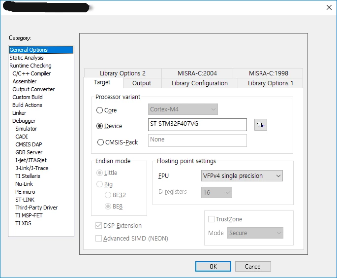

    Seems you are using floating point numbers anyway. Have you enabled the FPU ?
    If I remember correctly, IAR does enable the FPU automatically in the startup, if it is set in the project options (General Options-> Target, FPU).
    And check the device is set correctly (STM32F407xx, Cortex-M4F).

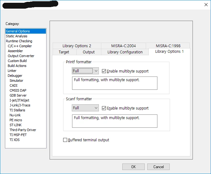

    Please check that the printf formatter is set to "Full" in the project's "General Option"=>"Library Options 1".
    km shim
    km shimAuthor
    October 22, 2018

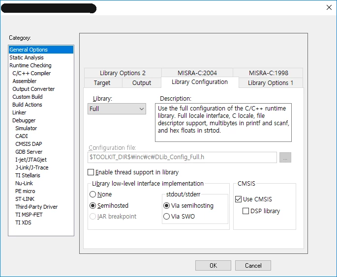

    Yes,
    Target, and library configuration. and also, debug info picture as following.
    FPU enabled routine. at that time FPU coprocessor info.

    I found the hints on Keil site(http://www.keil.com/support/man/docs/armasm/armasm_dom1361289950613.htm).
    They says that VCVT instruction can produce invalid operation, ....
    and also I found that vcvt.f64.f32 never used in the gcc asm code. so, suspected that there is problem in IAR tool chain. I reported this phenomenon to IAR.
    Thank all, very very much.
    AvaTar
    Senior III
    October 22, 2018
    According to the ARM infocenter site (http://infocenter.arm.com/help/index.jsp?topic=/com.arm.doc.dui0553a/CHDJAEDB.html), F64 is not a valid datatype for the M4 VCVT instruction.
