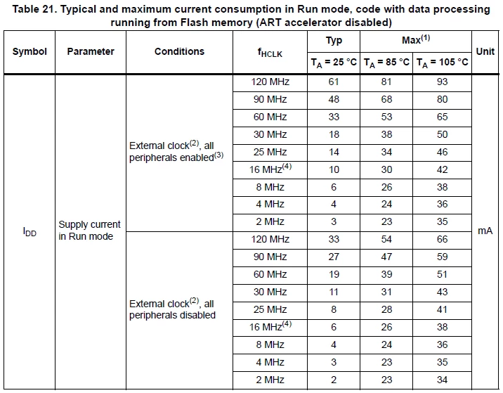

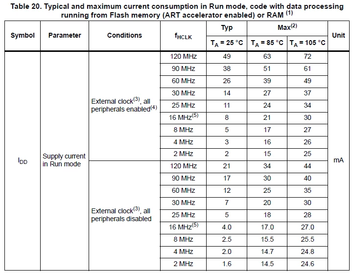

Why is not ART Accelerator always enable and working?
As far as I understand, ART Accelerator improve the performance of the microcontroller and make it to save power. If what I said is ok, why is not ART always working? Why I should enable it to work. Shouldn't it always be working to improve the microcontroller performance?
If you can recommend me some document to read, I would be great.
Thank you.
