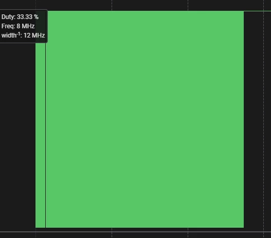

For some reason my MCO(PA8) only outputting 8MHz despite me configuring it for 60MHz
I am completely baffled because I have followed all the correct register settings(as far as I am aware) for the clock configuration, and have followed the clock diagram from the stm32cubeide
I'm working on an STM32U5G9x and its my first time working on such an advanced topic, so apologies beforehand.

Does your LA have enough sample frequency or do you see an alias frequency?
Looks like a screendump from "logic" which is often used with simple 24 MHz LA's.

I have tried it with the oscilloscope and it still gives 8MHz. My MCO is PA8. I configured it myself in the file I gave, but it should output more than 8MHz at the very least
