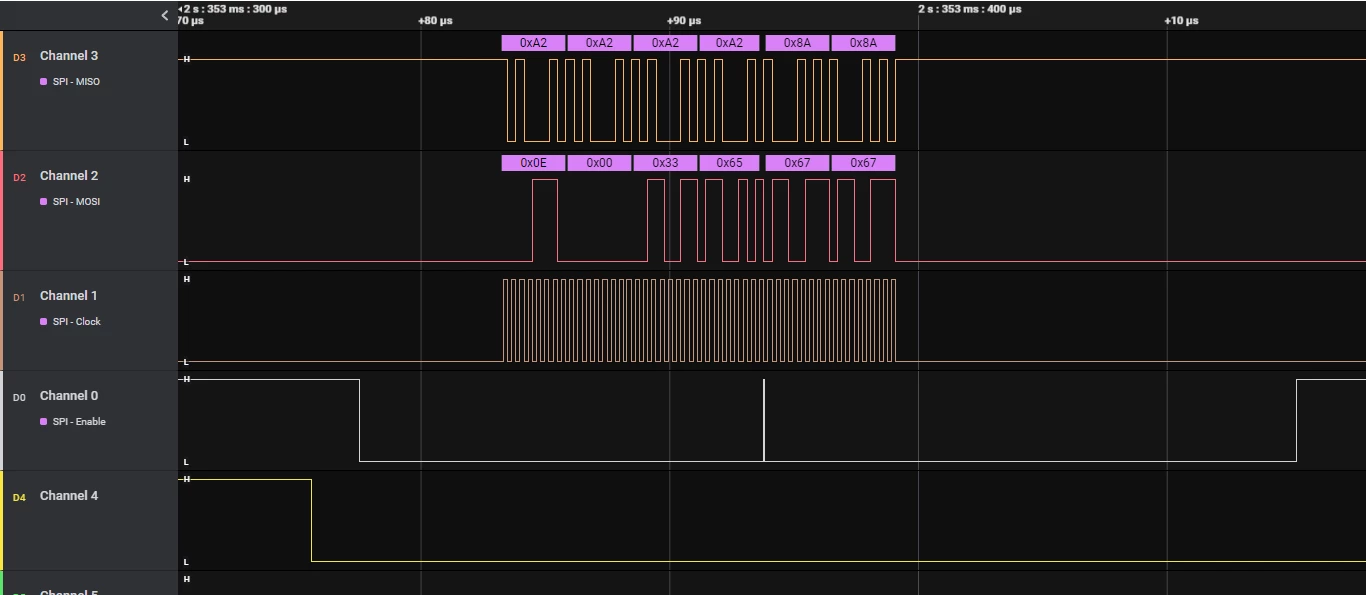

Hello I'm using SPI to interface my STM32F7 with the SX1262 radio.
I got a weird behavior, I'm using a GPIO to toggle the NSS pin. But sometimes it toggles randomly during the data transfer. You can see on the following screenshot of my logic analyzer:
0693W00000StrykQAB.pngHere's the code for it:

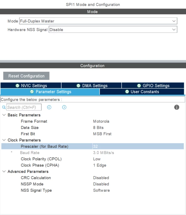

Here's the SPI setup:

If you have flying wires or a long ribbon cable, this may be result of inadequate ground/return arrangement and/or crostallk.
If this is the case, the remedy is short cables and individual ground/return for each signal. You can try to work around this by increasing the NSS pin's drive by its GPIO_OSPEEDR setting, and decrease other pins' drive.
LA may not be the most adequate tool for this kind of problems.

It was a wiring problem after all!
Thank you for the help

Measure NSS pin by oscilloscope.
