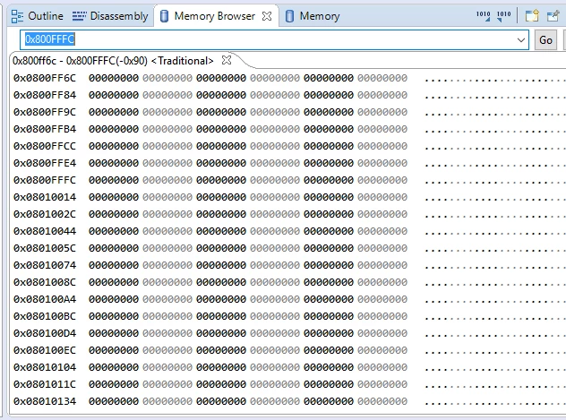

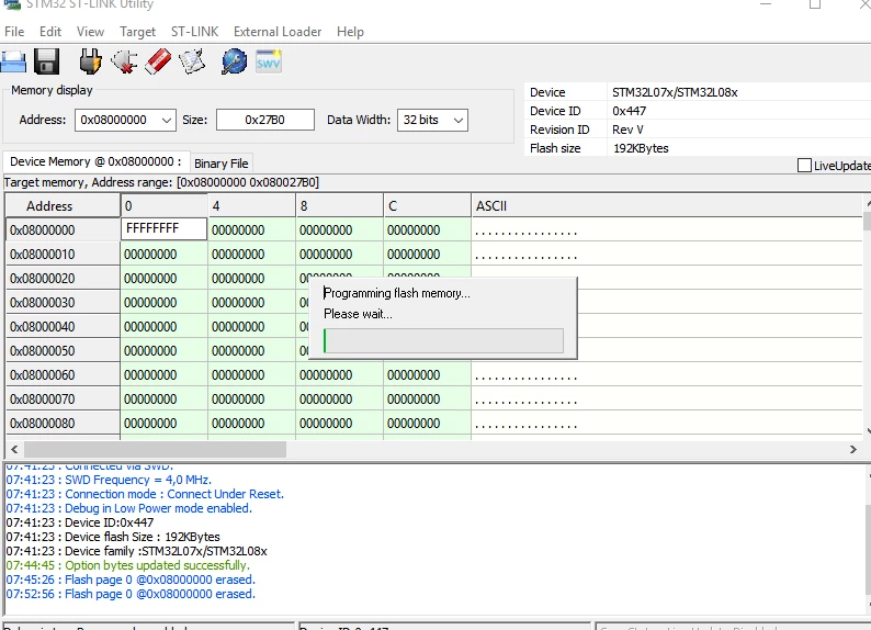

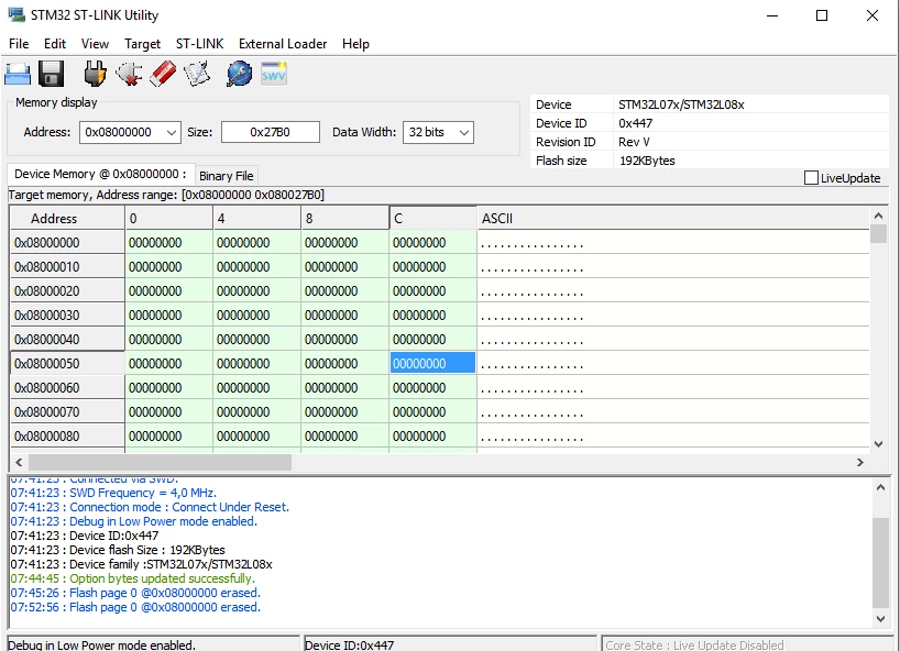

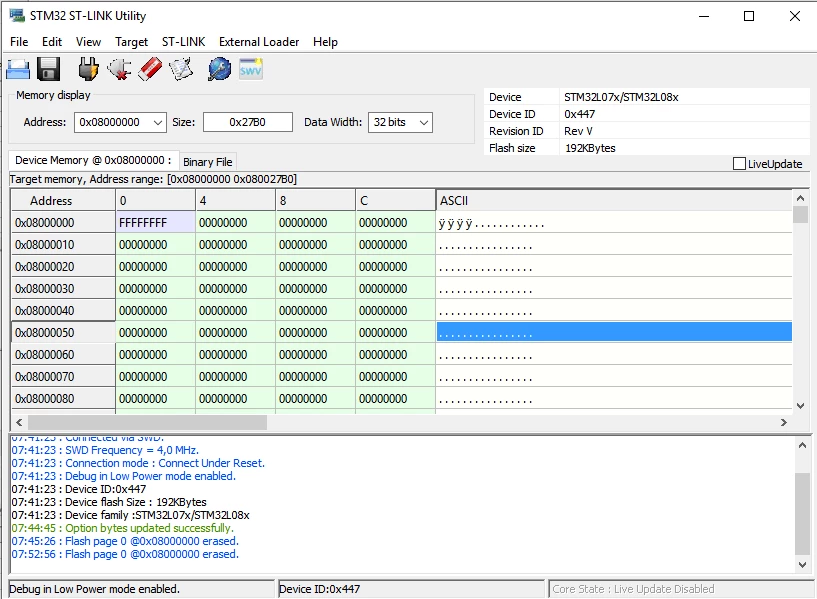

I'm currently working on a project using a STM32L072 controller.
One part ob that is implementing a customer-specific bootloader. No worries so far.
What confuses me is that an empty flash reads zeroes instead of FFs. This is with the ST-Link Tool, as well as with my debugger in Eclipse. I can correctly read out the programmed areas of the flash. What is even more weird is that i can program FFFFFF into the memory??
I already checked if any read protection is active, which isn't the case.
I attached some images to illustrate that behavior.
Can someone get this right for me please, what am I missing?
