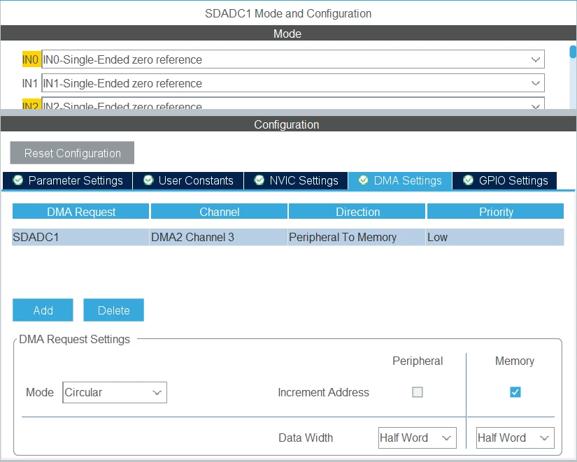

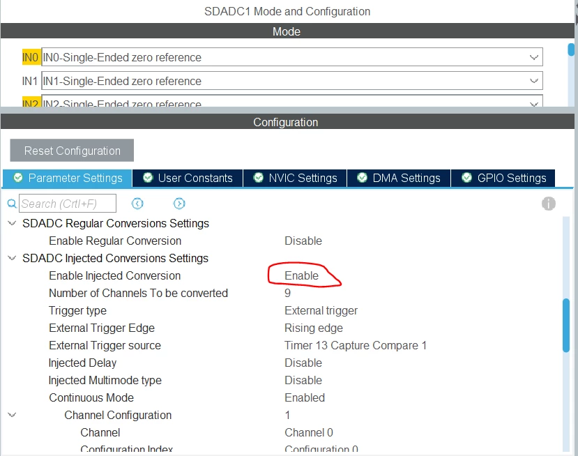

I'm doing SDADC and I think there is some issues with the DMA for SDADC in STM32CubeIDE 1.7.0.
First, I have enabled DMA for SDADC1, SDADC2, SDADC3 and I have selected InjectedConversion = ENABLE.
