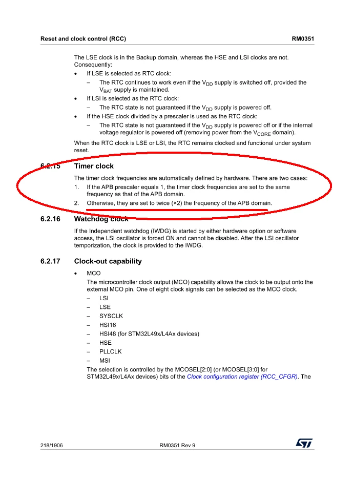

Why i didn't get 50hz frequency when i set internal clock(APB1 Timer clock) is 20mhz?
Board: STM32L496ZG
My requirement - 2ms dead time
Frequency - 50hz and Internal clock is 40mhz.
In 40mhz (internal clock) i got expected frequency (50hz) using
Prescaler = 80-1
Peroid value = 10000-1
PWM Counter =5000-1
Then, i reduced my Internal clock has (20mhz) same expected frequency (50hz) using
Prescaler = 40-1
PWM Counter =5000-1 instead of 50hz i got 100hz
Except 20mhz if i set (2.5mhz) and (0.625mhz) i got same expected frequency.
(Why its happening if i set 20mhz?)
How exactly? By setting APB prescaler to 2?
MSree.1
MSree.1Author
January 4, 2023
System clock = 80mhz
HCLK = 40mhz
APB1 Prescaler = 2
