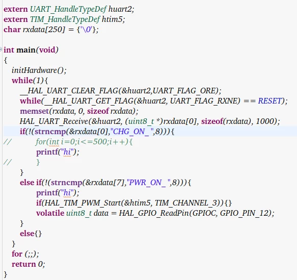

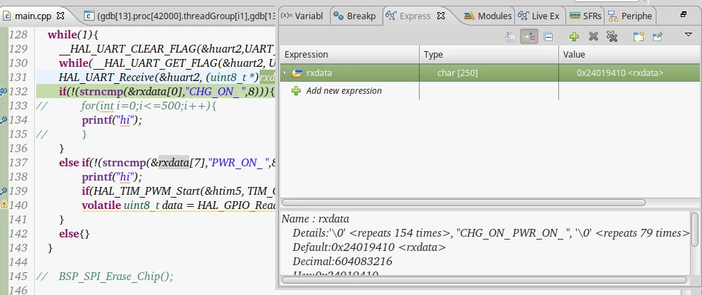

Why I could not receive the data properly in the UART ??
Hi Team,
I am using stm32h753 controller, While receiveing data in the UART. Rx buffer index is not always Rxbuff[0]. Data is received randomly in the different index.
Here i am attaching the reference.

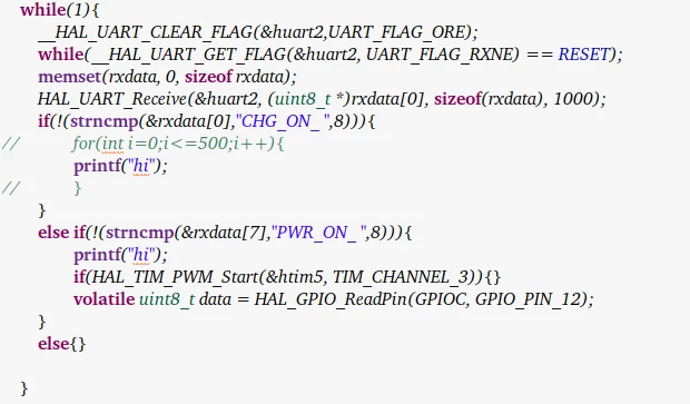

Sep 9, 2019 10:58 AM UTC
Hi Clive,
Please find the code..
buffer size in 250 .
I am receiving 16 byte data.

Tilen MAJERLE
Sep 9, 2019 8:59 AM UTC
Can you post the code how you receive data? It is unclear from your print screen.

Tesla DeLorean
Guru
Sep 9, 2019 10:06 AM UTC
Can't you just paste more complete code?
How large is the buffer?
You ignore error status from the function.
You ignore the fact data reception may be of different sizes, or shift in alignment/synchronization.​
