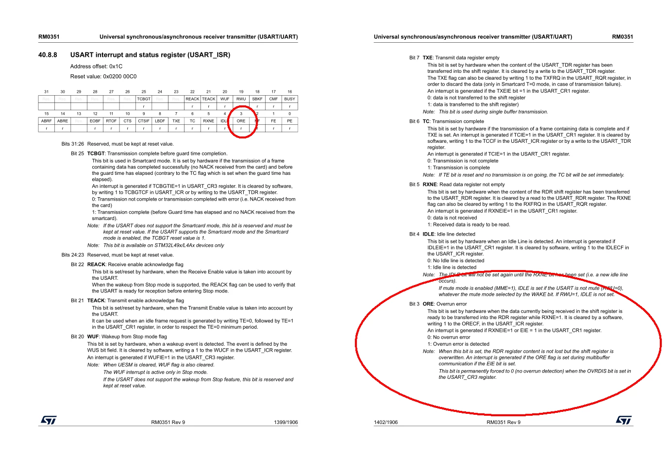

What is UART ORE?
0693W00000WKtFYQA1.png> I need for some reason to disconnect the cable connected to the TX pin of the STM32 and
> reconnect it to start the transmission: is there any way to correct this by software?
Do you mean you want to detect the cable being connected to Tx pin? You cannot test that reliably without some sort of loopback, i.e. having an extra contact in connector and an extra pin.

Although I have looked up what "OREFLAG" means but I can't find much information on what it is. What is UART ORE?
And I still have a problem: I need for some reason to disconnect the cable connected to the TX pin of the STM32 and reconnect it to start the transmission: is there any way to correct this by software? I have tried to simulate the signal at LOW and HIGH levels using a delay in between, but it doesn't work.

What is UART ORE?

I didn't really have the manual with me, I only managed to find a very elaborate datasheet of my IoT node.
The problem with me having to connect and disconnect the Tx pin is also solved by resetting the MCU, and reading this fantastic manual I have come to the conclusion that I am overlooking not setting the RXNE flag to "1" nor clearing the RQR register to be able to empty the RDR buffer.
I have tried implementing these two lines of code in the "HAL_UART_Receive()" function but my problem persists.
