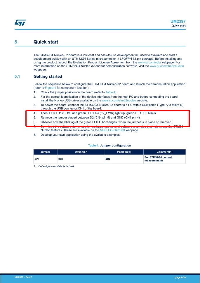

why does the nucleo-G431KB have a jumper on cn4

Best answer by waclawek.jan
> Or the demo code reads Arduino D2 (PA12) to determine LED rate

Grounds PA12/USB_DP, defeats the internal pull-up, probably relates to how it starts
CN4.4 GND
CN4.5 D2 PA12 USB_DP

ok i plugged it in i just got it in the mail btw and the usr led blinks faster if u unplug it and blinks slower if u have it plugged in so im guessing its just a extra jumper the give u possibly to mess with the bootloader or anything else
