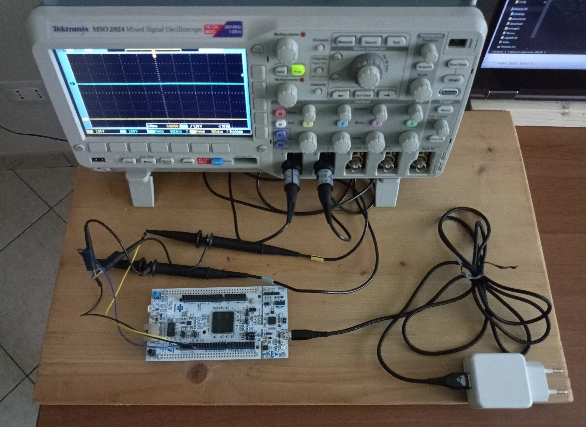

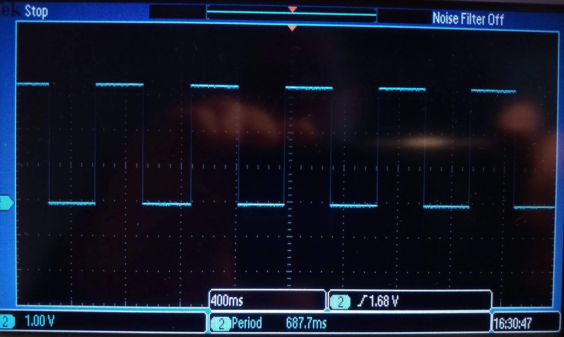

I measure the execution time of a function by putting the toggle of a digital output and the function call into a cycle and measuring the period of the square wave at the digital output with an oscilloscope. The execution time is half a period.
To test the procedure, I used instead of the function a dummy code (see main function in the annex execution_time_main.c) where the cnt_max parameter allows me to vary the amount of code to execute.
I do not understand why both with the ARM V5 and V6 compiler in Keil uVision the trend of the periods is that shown in the attachment CRAZY_TIMES.jpg
  • Comp V5, test case 8 to 9 cnt_max go from 8000 to 9000 (increases) and  period go from 485 us to 454 us (decreases) !
  • Comp V5, test case 10 to 11 cnt_max go from 10 000 to 100 000 (x 10) and period go from 505 us to 11.1 ms (x 22) !
  • Comp V6, test case 10 to 11 cnt_max go from 10 000 to 100 000 (x 10) and period go from 607 us to 29.6 ms (x 49) !
Thanks

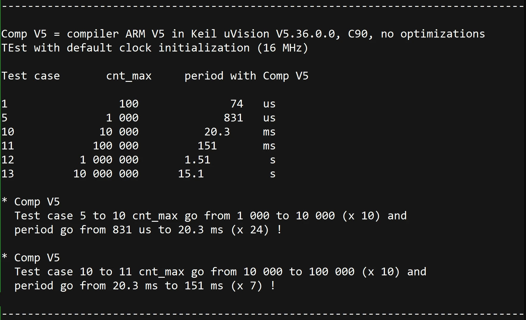

I wondered that I made some mistake in my clock_configure function so I disabled it leaving the default clock initialization (now SYSCLK frequency = 16 MHz and not 216 MHz as before, ...)
#if 0
  clock_configure();
  SystemCoreClockUpdate();
#endif
I do not understand why (now i tested only with the ARM V5 compiler) the trend of the periods is that shown in the attachment CRAZY_TIMES_2.jpg
  • Comp V5, test case 5 to 10 cnt_max go from 1 000 to 10 000 (x 10) and period go from 831 us to 20.3 ms (x 24) !
  • Comp V5, test case 10 to 11 cnt_max go from 10 000 to 100 000 (x 10) and period go from 20.3 ms to 151 ms (x 7) !
just to make sure, I have also determined the periods using the debugger and they are in very good agreement with the measurements made with the oscilloscope.
So the problem is not in my clock_configure_function or in the oscilloscope.

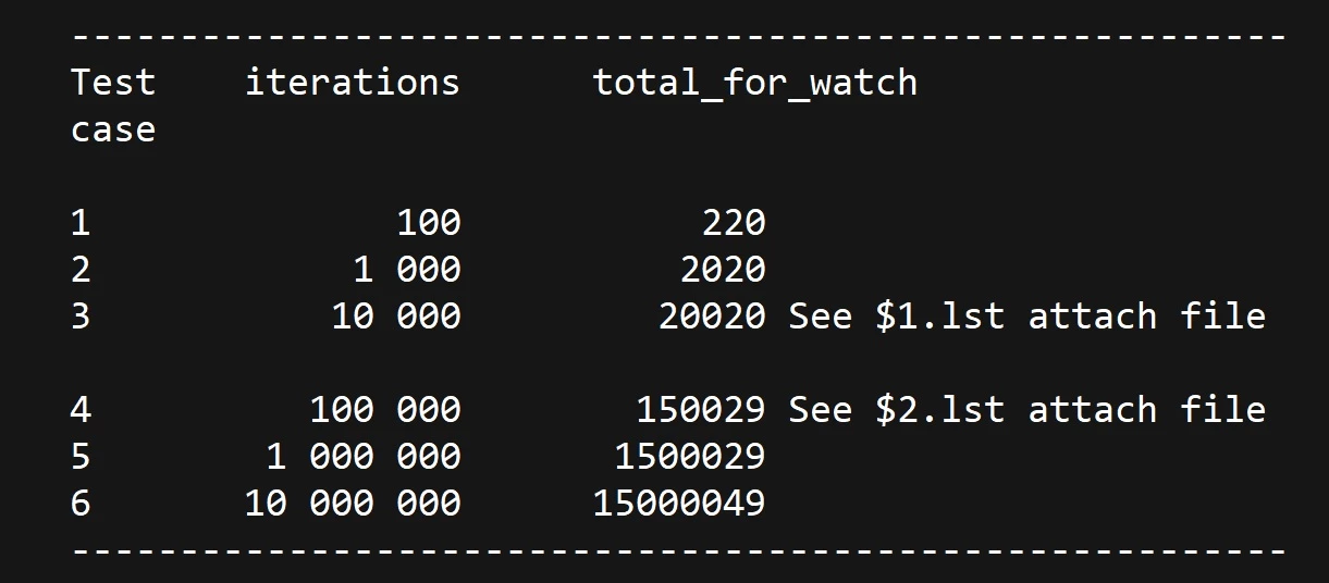

Very simple case for analysis
Hi
To simplify the analysis, I have now concentrated on a single anomaly that is highlighted by simply using the exact same source code except for the iterations parameter which assumes different values (100, ... 10 000 000).
Here I have collected the different suggestions given to me by @Community member​, @TDK​ and @KiptonM​.
  • Interrupt are disabled (__disable_irq(); in line 13).
  • DWT->CYCCNT was used instead of the oscilloscope.
  • All tests now use a single function
  • Disassembly is now available (ATTACH_FILE_#2 list files $1.lst about test case 3 and $2.lst about test case 4)
Follow the code for test case 3 (iterations = 10000).
#include "stm32f767xx.h"
const uint32_t iterations = 10000UL;
volatile uint32_t total_for_watch = 0;
void test_function (uint32_t iterations);
int main (void)
 uint32_t start = 0;
 uint32_t finish = 0;
 __disable_irq();
 for (;;)
 start = DWT->CYCCNT;
 test_function(iterations);
 finish= DWT->CYCCNT;
 total_for_watch = finish - start;
 return 0;
 uint32_t cnt = 0;
 /* Dummy code */
 while (cnt < iterations)
 cnt++;
A summary of the results follows
0693W00000KZvpBQAT.jpgThe anomaly is that in test case 3 to 4 iterations go from 10 000 to 100 000 (x 10) and  total_for_watch go from 20020 cycles to 150029 cycles (x 7.5) !
All tests are with Compiler ARM V5 (in Keil uVision 5.36) without optimizations in C99 mode.
Note. In other tests not documented here I have seen that the total_for_watch  values are consistent with time measurements obtained using digital output
toggles and oscilloscope. I therefore believe the total_for_watch values to be reliable.

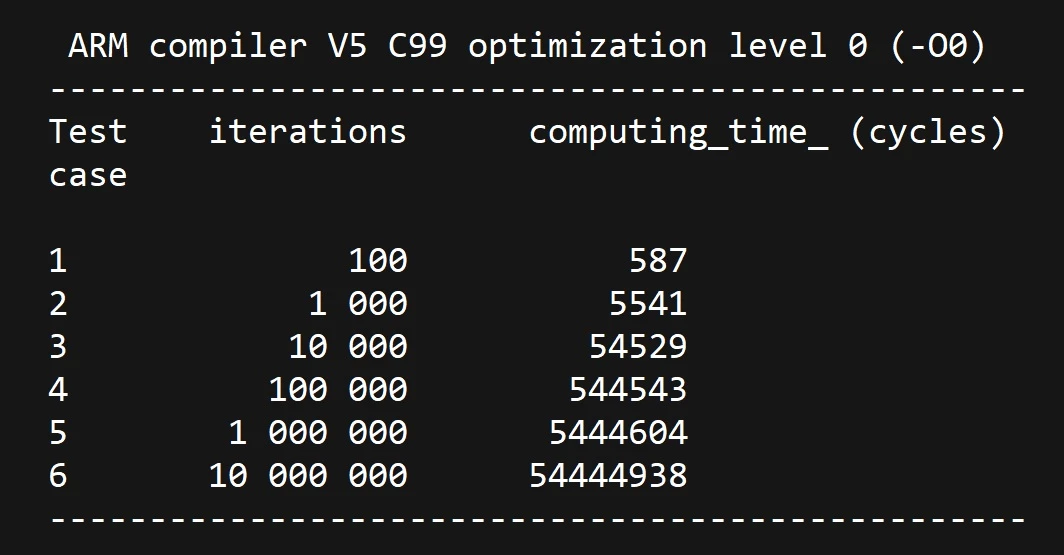

February 21, 2022
You're still not calling the function multiple times within the same program. Create a program with all of them within the same program. Otherwise, you still have a compilation step which is changing the code.
uint32_t start = DWT->CYCCNT;
test_function(100);
uint32_t end1 = DWT->CYCCNT - start;
test_function(1000);
uint32_t end2 = DWT->CYCCNT - end1;
test_function(10000);
uint32_t end3 = DWT->CYCCNT - end2;
test_function(100000);
uint32_t end4 = DWT->CYCCNT - end3;
test_function(1000000);
uint32_t end5 = DWT->CYCCNT - end4;
In your disassembly, you can see the compiler is doing different things based on the value you're using. It does seem like an alignment thing.
 0x08000374: f2427010 B..p MOV r0,#0x2710
 0x08000378: f000f80a .... BL test_function ; 0x8000390
 0x08000374: 4805 .H LDR r0,[pc,#20] ; [0x800038c] = 0x186a0
 0x08000376: f000f80d .... BL test_function ; 0x8000394
Silvano
SilvanoAuthor
February 22, 2022
Hi @Community member​, @KiptonM​, @TDK​  and @Community member​
TDK is right. Test results follow
0693W00000Ka3fnQAB.jpgThe code used follows.
uint32_t last_dwt_cyccnt, current_dwt_cyccnt;
/* Variable for watch */
volatile uint32_t computing_time_1, computing_time_2, computing_time_3,
 computing_time_4, computing_time_5, computing_time_6;
int main (void)
 __disable_irq();
 for (;;)
 last_dwt_cyccnt = DWT->CYCCNT;
 test_function(100UL);
 current_dwt_cyccnt = DWT->CYCCNT;
 computing_time_1 = current_dwt_cyccnt - last_dwt_cyccnt;
 last_dwt_cyccnt = current_dwt_cyccnt;
 test_function(1000UL);
 computing_time_2 = current_dwt_cyccnt - last_dwt_cyccnt;
 test_function(10000UL);
 computing_time_3 = current_dwt_cyccnt - last_dwt_cyccnt;
 test_function(100000UL);
 computing_time_4 = current_dwt_cyccnt - last_dwt_cyccnt;
 test_function(1000000UL);
 computing_time_5 = current_dwt_cyccnt - last_dwt_cyccnt;
 test_function(10000000UL);
 computing_time_6 = current_dwt_cyccnt - last_dwt_cyccnt;
 return 0;
 volatile uint32_t cnt = 0;
 /* Dummy code */
 cnt++;

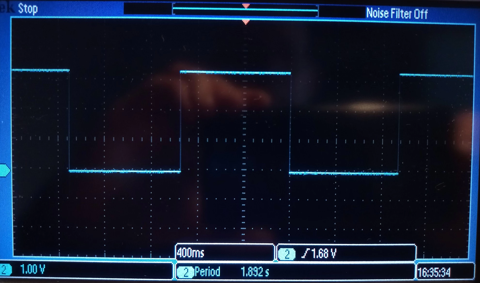

But my original problem was that it seemed strange to me (and therefore I thought I had made some mistakes) that very small changes in the code could result in very large changes in the runtime. For example, consider the following code, which I call %2.
volatile uint32_t computing_time_1, computing_time_2, computing_time_3;
volatile uint32_t computing_time_4, computing_time_5, computing_time_6;
int main (void)
 volatile uint32_t system_core_clock_for_watch = SystemCoreClock; // @1
 __disable_irq();
 for (;;)
 return 0;
 /* Dummy code */
 cnt++;
Then consider the following code, which I call %3.
The only difference is that in% 3 the line 14
present in% 2 has been deleted.
int main (void)
 //volatile uint32_t system_core_clock_for_watch = SystemCoreClock; // @1
 __disable_irq();
 for (;;)
 return 0;
 /* Dummy code */
 cnt++;
!!! computing_time_5 went from 5 444 543 cycles to 15 000 038 cycles (3 x).
See ATTACH_FILE_#3 list files %2.lst about code %2 and ATTACH_FILE_#3 list files %3.lst about code %3 (ARM compiler V5, C99, optimization level 0 (-O0)).
I also found similar behaviors also making other very small changes in the code other than the one now shown or with the ARM 6 compiler.
I am new with ARM. My previous experiences are related to Microchip's simple dsPIC MCUs or Motorola's older 68000 CPUs but I have never experienced such a high sensitivity of execution times towards the code.
Am I the only one who finds this behavior "strange" or for you who move in the ARM world with more experience than me is this behavior normal ?

I had similar problems without using the debugger, but measuring times by toggling a digital output and measuring the period with an oscilloscope
0693W00000Ka6K0QAJ.jpgFor example, consider the following code

Period measured with oscilloscope of signal at PB10 digital output is 687.7 ms
If you delete line 10
the period becomes 1.892 s (x 2.75)
