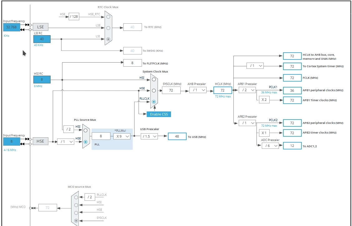

It works with DMA_CIRCULAR (but I do not want or need continuous DMA transfers.)
You see by the terminal output below that reading 2 analog inputs works OK. However, after a while (< 1 minute) the 2 analog values are exchanged now. Apparently the DMA gets confused, but how and why I cannot understand.
Here is the code, all initialization was generated by STM32CubeMX, v5.5.0. (Had to omit part due to website restrictions on size of message.) NUM_AN_INPUTS=2

11 replies
waclawek.jan
February 13, 2020
Do you look at the ADC registers in debugger? If yes, then don't.
Jwork.1

waclawek.jan
February 13, 2020
John,
if you stop-start the DMA while conversions are started automatically, conversion results are inevitably lost while DMA is not running.
In the original case, what happens if you read out the ADC data register manually before each subsequent HAL_ADC_Start_DMA() call?
I don't Cube.

waclawek.jan
February 14, 2020
Print out CNDTR of respective DMA channel and also the ADC status register.

waclawek.jan
February 16, 2020
John,
Can you please do it again, this time printing ADC1->SR *before* reading ADC1->DR?
My theory is, that DMA misses one transfer, but I don't quite understand, why. What are the AHB and APB clocks, and what is the ADC clock?

Not sure if the picture of the clock configuration will get scrubbed, so:
AHB clock =  Is that the same as HCLOCK? I know that Hclock= Sysclock/1
= 72Mhz
APB1 (peripheral) clock = 36 Mhz, APB1 timer clock = 72Mhz
APB2 (peripheral) clock = 72 Mhz, APB2 timer clock = 72Mhz
ADC clock = 12 MHz

This is the complete clock configuration
