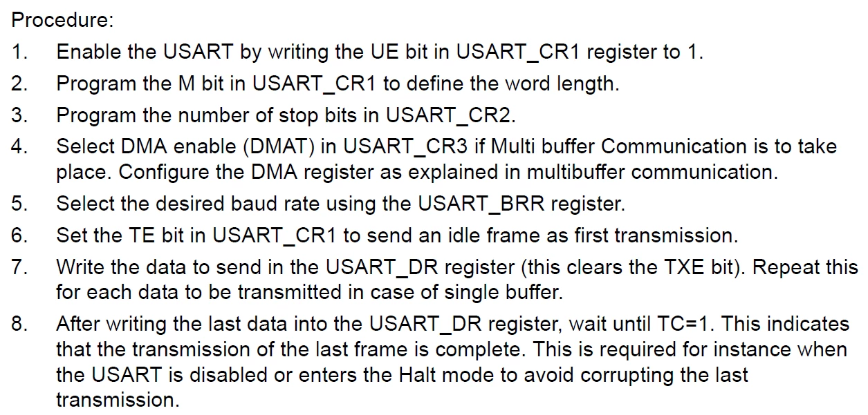

Why does the debugger not respond after UE bit is set for UART4?
Hello everyone!
My setup uses a STM32407VG. I have been using for some time now and have gotten used to how to read the datasheet and use some of features. Today I am trying to get UART4 transmitting some data.
Here is how I went about getting it all setup:
  1. UART4 TX can be used on PC10. Therefore we must enable the AHB1 to turn on GPIOC.
  2. The UART4 module itself is one APB1 so that must be enabled as well.
  3. Via MODER, OTYPE, OSPEEDR PUPDR, I also make sure its push pull, disabled pullups and output speed is medium. Pretty sure I don’t need to do this but I did it anyway!
  4. Via AFR[1], I set the MODER register for GPIOC to be as alternate function mode.
  5. My system clock is running at 168MHz (verified from previous projects), and my APB1 PCLK1 is 42MHz. Via the BRR, I set the baudrate and used this formula: BRR = [pclk + (baud/2)] / baud. I set CR1 to 0x04 to set the TE bit and other parameters.
  6. Here is where I get some problems, I set the UE bit in CR1.
I did step through the debugger (via STLINK) and it appears I am setting all of the correct bits. But when I land on that UE bit, I get the error (in the console) Target is not responding, retrying… until it times out. Below is a code snippet.

TDKBest answer
October 6, 2021
Might not be it, but the RM says to enable UE first, then do everything else.
Code is easier to read if you use standard defines than custom bits
UART4->CR1 |= (1U << 13); --> UART4->CR1 |= USART_CR1_UE;
Custom board? Make sure PC10 isn't connected to anything else that will disrupt the debugger. Set it as GPIO and toggle it.

JCorl.1
JCorl.1Author
Senior
October 6, 2021
Hey thanks for the reply! I properly corrected the order and also used the standard defines where it was missing.

Yes its a custom board. I checked to make sure I was able to toggle it when its configured as an output (push-pull). I got alternating signals when toggling it in a while loop. So the pin seems to be okay. I should note there is a 1kohm pullup on it for a different configuration in my project (open drain mode for 1-wire bit banging). It doesn't seem to hurt it when in strictly output mode. Since UART is configured as push-pull as well, I think its okay.
When I run the altered code, I can set the UE bit fine now. The target does not respond when it executes its last line (trying to return from the function). So I tried commenting in and out some code. I found that UART4->BRR was causing problems with the debugger. Maybe changing the baudrate messes up debugging? It seems so. So I let the code run and ran an infinite while loop..... I finally get data! But garbage data. I am using my protocol analyzer within the logic analyzer I am using and it keeps getting "framing error". Hey I am closer :)

October 6, 2021
You're still not doing the correct order of initialization. TE should be last.
I would test the code on known good hardware such as a nucleo board. Upload your schematic if you want.

Sorry about that! I was careless with the pasting of the up to date code. Here it is:

	// STEP 0 - Enable the bus to UART4
	RCC->APB1ENR |= DKO_UART4_ENABLE;
	// STEP 1 - Enable the UART (PC10=TX PC11=RX) by setting the UE bit (uart enable bit)
	UART4->CR1 |= (USART_CR1_UE);
	// STEP 2 - Set the M bit
	UART4->CR1 |= (USART_CR1_M);
	// STEP 3 - Set the stop bits
	UART4->CR1 |= (USART_CR2_STOP_1);
	// STEP 4
	// NONE
	// STEP 5 - Set baudrate to be 19200; formula is BRR = [pclk + (baud/2)] / baud
	UART4->BRR = 4376;//2188;
	// STEP 6 - Set the TE bit
	UART4->CR1 |= USART_CR1_TE;
I think the 1kohm pullups really messed up the UART. Took some hot air and removed them, did the trick. Now I am finally getting some clear data. Thank you for the help! Where can I place some money to buy you a coffee? :p
