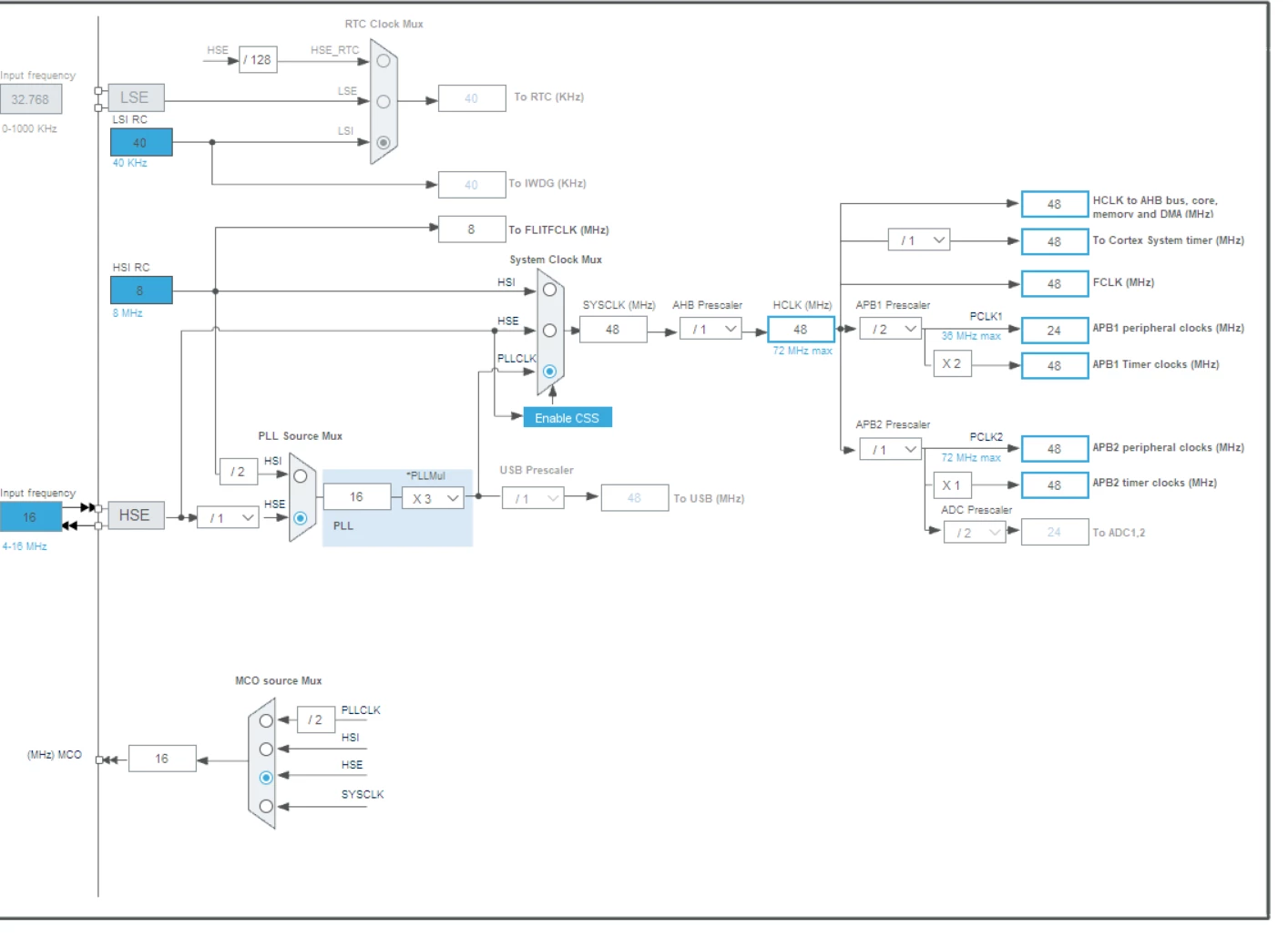

I am currently having trouble with a Hard fault issue that I cannot understand and I was hoping someone might have come across a similar issue. I have a Crystal Oscillator with a 16MHZ clock at the input. I use the MCO pin from the microcontroller to provide clock to an additional ASIC. I have observed that the microcontroller is very sensitive to the offset of the clock input. Additionally, the microcontroller works as expected at room temperature but as soon as I increase the temperature to 70°C the MCU enters into hard fault whenever I restart the MCU. It can work perfectly fine for temperatures beyond 90°C as long as I do not restart the MCU. The clock input is always okay also when it runs itself into a Hard Fault.

Check the PLL multiplier settings, and FLASH Wait States
Check HSE_VALUE define, most F1 expect an 8 MHz source
Check using BYPASS mode for external sources (ie TCXO).

I am using a STM32F103C8T7 and it supports 16MHz. The PLL multiplier is 3 and all the clock for the peripherals should also be ok. Attached you can see the screenshot with the current clock configuration. Flash latency is set at 1 wait state. I have however also test it with 2 wait states without any advantage. I try using the bypass mode, havent tried it yet. I have however used the RCC_HSEConfig(RCC_HSE_ON); to provide the external clock.

Yeah, I think fPLLCOMP needs to be 4 MHz, the 8 MHz sources they divide by 2
void SystemClock_Config(void)
 RCC_ClkInitTypeDef clkinitstruct = {0};
 RCC_OscInitTypeDef oscinitstruct = {0};
 /* Enable HSE Oscillator and activate PLL with HSE as source */
 oscinitstruct.OscillatorType = RCC_OSCILLATORTYPE_HSE;
 oscinitstruct.HSEState = RCC_HSE_ON; // RCC_HSE_BYPASS; // External Source
 oscinitstruct.HSEPredivValue = RCC_HSE_PREDIV_DIV4; // 4 MHz PLL comparison
 oscinitstruct.PLL.PLLState = RCC_PLL_ON;
 oscinitstruct.PLL.PLLSource = RCC_PLLSOURCE_HSE;
 oscinitstruct.PLL.PLLMUL = RCC_PLL_MUL12; // 4x12 48 MHz
 if (HAL_RCC_OscConfig(&oscinitstruct)!= HAL_OK)
 /* Initialization Error */
 while(1);
 /* Select PLL as system clock source and configure the HCLK, PCLK1 and PCLK2
 clocks dividers */
 clkinitstruct.ClockType = (RCC_CLOCKTYPE_SYSCLK | RCC_CLOCKTYPE_HCLK | RCC_CLOCKTYPE_PCLK1 | RCC_CLOCKTYPE_PCLK2);
 clkinitstruct.SYSCLKSource = RCC_SYSCLKSOURCE_PLLCLK;
 clkinitstruct.AHBCLKDivider = RCC_SYSCLK_DIV1;
 clkinitstruct.APB2CLKDivider = RCC_HCLK_DIV1; // 72 MHz Max
 clkinitstruct.APB1CLKDivider = RCC_HCLK_DIV2; // 36 MHz Max
 if (HAL_RCC_ClockConfig(&clkinitstruct, FLASH_LATENCY_1)!= HAL_OK)
 while(1);
