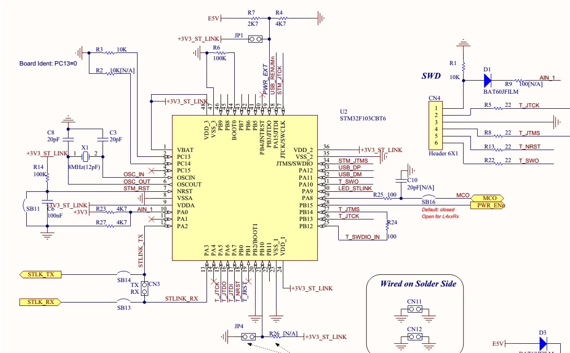

Why does Nucleo's PA 3 terminal show 3.3 V with ADC
Posted on July 25, 2017 at 01:56
Thank you for your patronage.
I'm Japanese student. Sorry for my poor English.

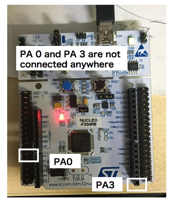

I'm using STM32F334Nucleo.

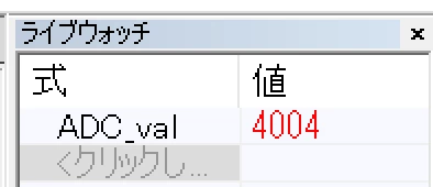

Nucleo's PA 3 terminal indicates about 3.3 V in ADC in a situation where nothing is connected.

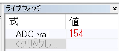

On the other hand, the PA0 terminal shows about 0V in the AD conversion in a situation where nothing is connected.
Why do these two differ?

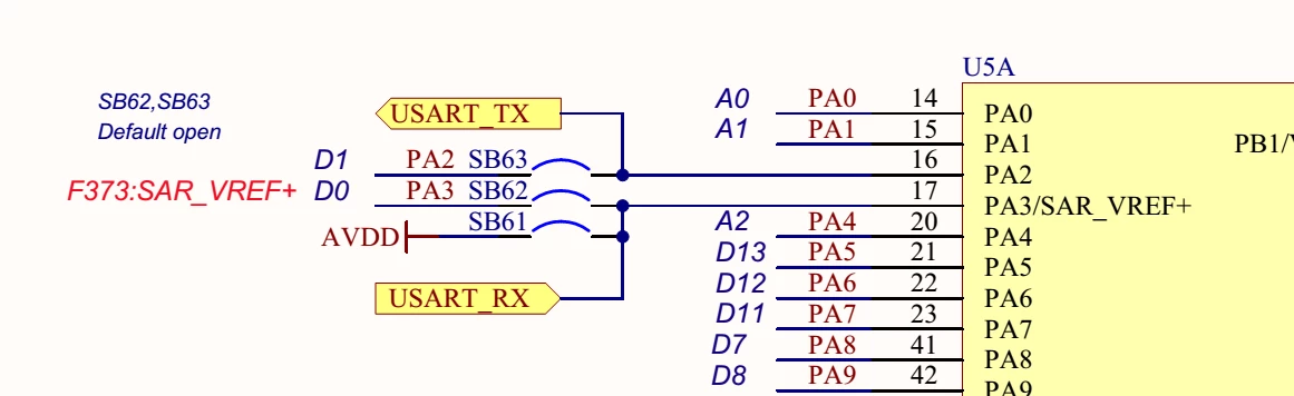

    Probably because it is connect to the VCP USART from the ST-LINK. Review the schematic

    this is your target mcu
    belowed is your st-link
    you should probably removed SB13 and connect SB62

    Or just use the pins designated for the Arduino analogue interface.
