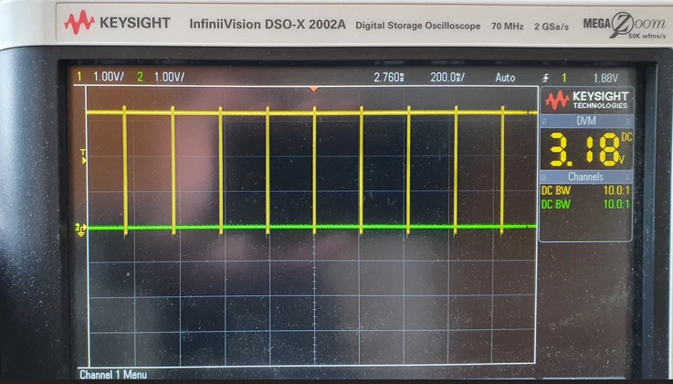

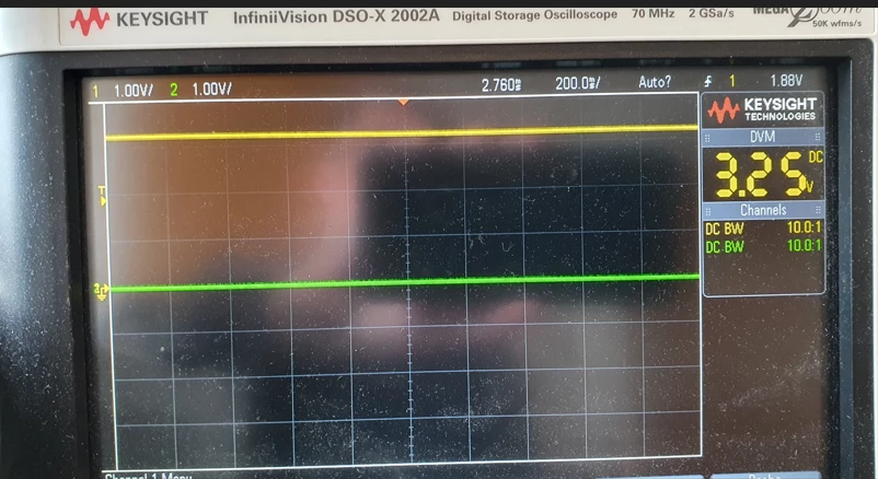

then everything seems to work flawlessly. However, I need to use an interrupt based system for my proper code (i.e. not the dummy code) and using interrupts is where I'm findings lots of problems. So the first issue I have is when slave is set to polling mode and master is set to transmit in interrupt mode. When debugging the slave, I noticed that the data wouldn't get sent unless the master was reset after a power cycle. Hooking a scope up to the i2c line, I see that on a power cycle, the line is just held high. If i reset the master (pulldown on the rst pin) everything works as expected and a transfer occurs.

This is measured on the i2c line after a power cycle and stays this way permanently:
0693W00000Nr0jTQAR.png And here is after a reset, you can see that the master is attempting to communicate with the slave every 200ms (it is unsuccessful but that's for another question):
0693W00000Nr0k2QAB.png Any help or ideas would be appreciated - I've found the i2c to be by far the most diffcult peripheral to work with on the stm32f4 so far!

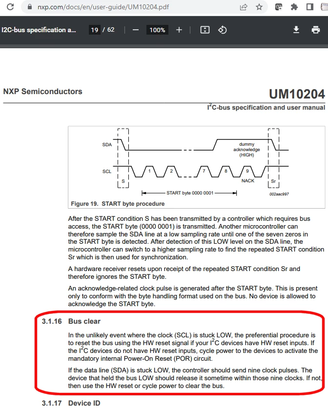

Maybe you I2C peripheral(s) is/are not powering-up cleanly?
It is in the nature of I2C that there's potential for lock-up.
The I2C specification gives a process for clearing the bus:
