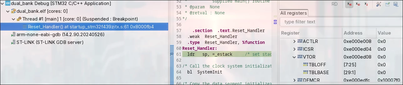

Oct 2, 2025 12:52 PM UTC
Thanks TDK,
Sorry for not replying earlier, I somehow missed the notification.

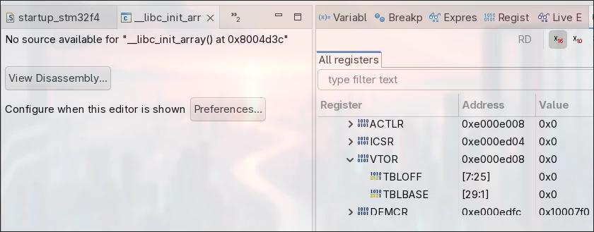

VTOR is set to 0 when I inspect it using the debugger at the reset handler and it stays that way as far as I can see.
The program reaches main and after jumping over MX_ETH_Init() I am brought back to the reset handler for some reason. I recall reading that the ethernet configuration messes with the same register as VTOR I think but I don't know if its related here.

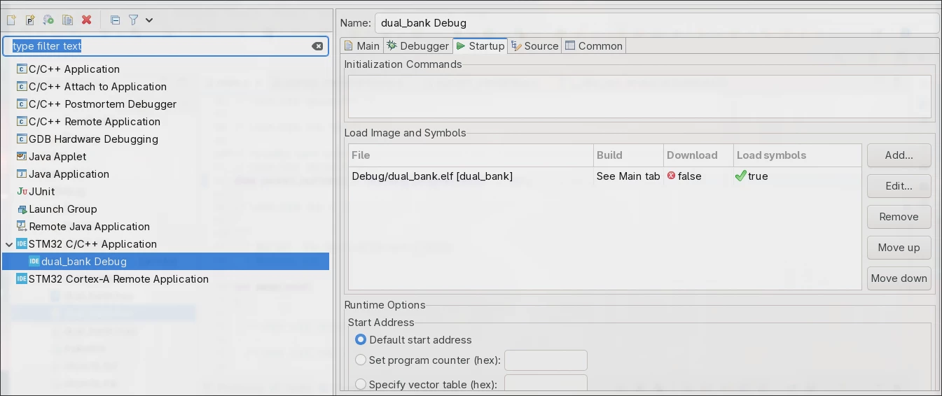

I then disable downloading of the flash application when running with the debugger like so:
I do get this when debugging as well :
Seems strange since the last compiled application is the one for bank 2 (the one I am running currently).

I'm not sure why the behavior you describe is running counter to how the reference manual says the chip operates. I tend to side with the RM unless presented with a minimal working example which shows the fault. It could be you are missing something. Change your program so it only flashes an LED. Does it work correctly in that case?
I still think debugging the "not working" is your best bet to a solution.
