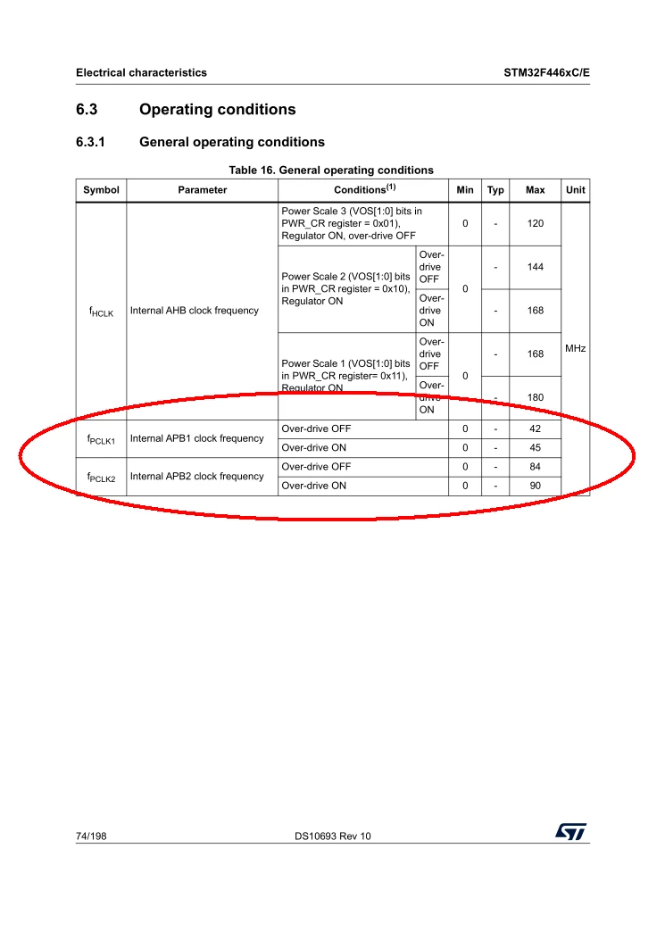

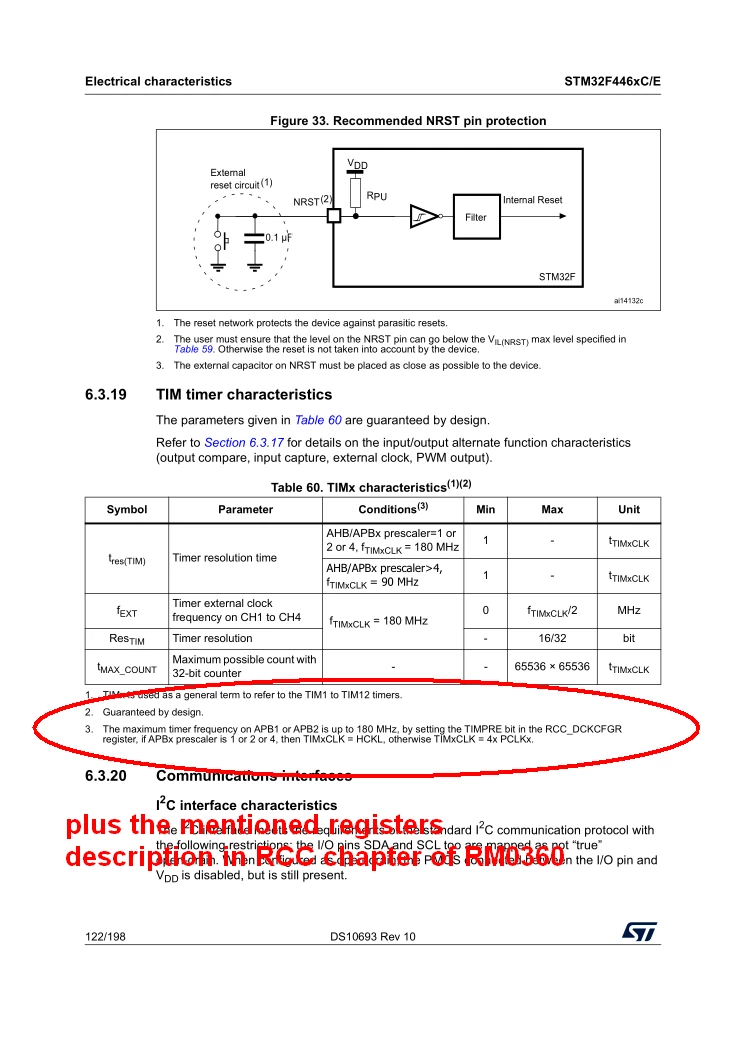

Hello
I'm using timers with DMA and I was asking myself of the use of having different clocks for timer clock and timer bus. For example timer 2 has a 90 MHz clock and a 45 Mhz bus. What would be the limitations of the bus?
Best answer by waclawek.jan
0693W00000StzmmQAB.png> What would be the limitations of the bus?
0693W00000StzmSQAR.pngJW

August 29, 2022
