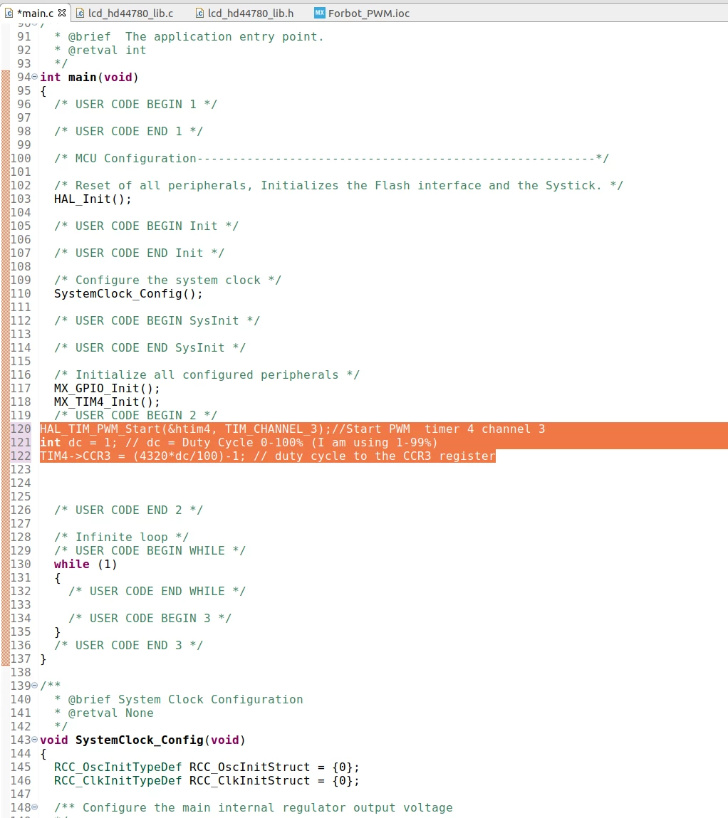

Why are the PWM pulses distorted when I set the duty cycle of the pulse cycle 1% -3% and 98% -99%?
  • May 31, 2020
  • 2335 views

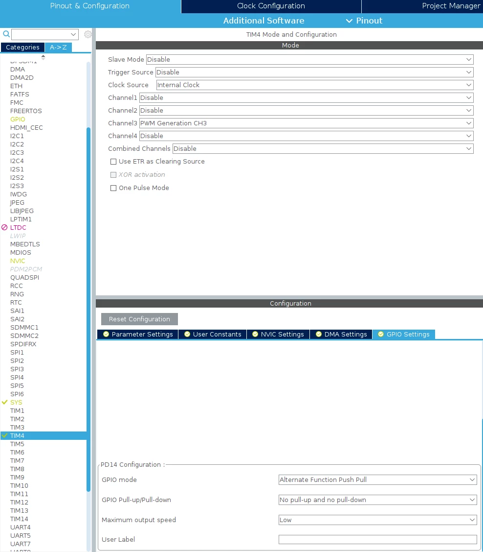

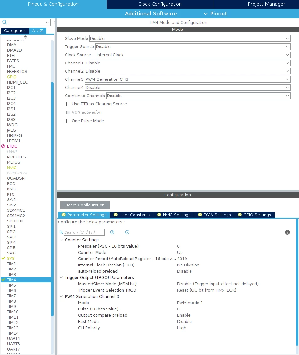

Hi, I configured PWM 25 kHz on Nucleo-767ZI to control the PWM fan.
When I set up Duty Cycle 1% -3% and 98% -99% the PWM signal is deformed.
When the Duty Cycle is 4% to 97% PWM signal is good.
Can it be improved or is it normal?
Regards

That's your oscilloscope's inability to trigger on short pulses, or maybe it's set so (search for "HF rejection, noise rejection" in Trigger settings).
RMcCa
Senior II
June 1, 2020
This is normal for pwm. Designers often use 5%-95%.​
