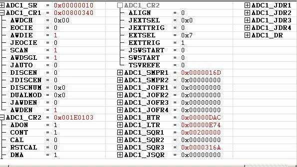

The code is as follows....

The registers seem to be set correctly....
The analog voltage read in is 3794. Since the high threshold is 3700 shouldn't the analog watchdog have been triggered?

    ​Correction...
    uint16_t lowThreshold = 3300;
    uint16_t highThreshold = 3500;
    Actual still 3794.
    I was changing thresholds to and the previous was incorrect. No matter what the threshold I don't get the interrupt.
