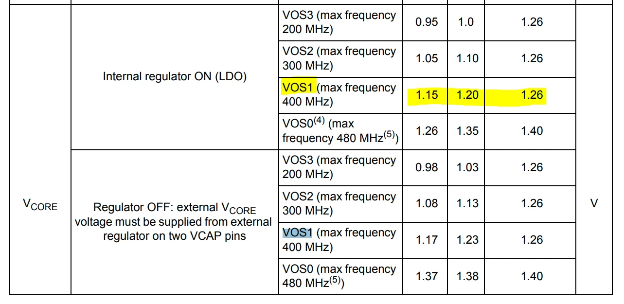

Custom board? How is VCORE supplied? What is voltage on VCAP pins if you measure them with multimeter?
MSale.4
MSale.4Author
March 1, 2022
Yes, a custom board. VCORE is supplied from internal LDO (1.2uF capacitor is connected to VCAP pin). The voltage is 1.01V
March 1, 2022
That's below the VOS1 threshold, so bits not being set is the correct behavior.
Not real sure.
There are two VCAP pins, both should have a 2.2uF cap.

You're right, there are two VCAP pins and a 1.2uF cap is connected to each one (so no mistake in this part). I made a little change in my code and I think the problem is solved (Actually I wrote the value of the PWR_CR3 register equal to its reset value! (I don't know why but it works!):
 int main(void)
 PWR->CR3=0x00000004; //Activating single write enabled to supply configuration
 PWR->CR3=0x00000002; //Normal operation and LDO is enable
 PWR->D3CR=0x0000C000; //changing voltage scaling to VOS1
 while(((PWR->CSR1)&(0x00002000))==0); //Waiting for voltage scaling
 while(((PWR->D3CR)&(0x00002000))==0); //Waiting for voltage scaling
