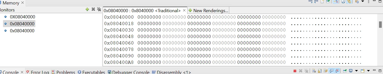

while i am trying to write data in flash memory data isn't being written in memory
While I am trying to write data in flash in memory it isn't being updated in the particular memory location while checking in debug session. And memory locations are showing 00000000 by default instead of FFFFFFFF and the image for same is attached hereby.
I have also added one file named FLASH_PAGE.c which is also attached hereby. Kindly provide some solution for this issue.

    > EraseInitStruct.Page = StartPageAddress;
    It's expecting a page number. You appear to be providing an address.
    Could be other things going on here. When unexpected, all 0's can indicate the debugger cannot read those memory locations.

    As @mƎALLEm said, you need to state the STM32 part number. Does it have cache?
    In your Flash_Write_Data() function, you don't check the return values from HAL_FLASH_Unlock() or HAL_FLASH_Lock(). Are they succeeding?
    Does HAL_FLASHEx_Erase() return any error?
