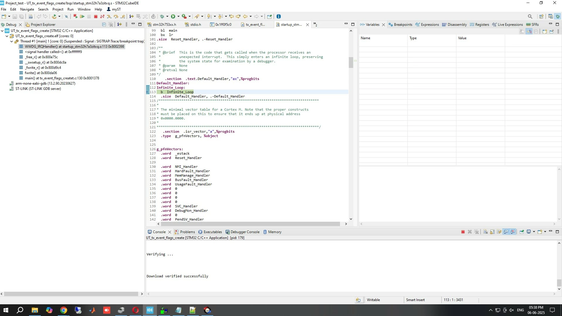

while debugging loop stop here in my stm32_h7a3zi-q porting custom threadx

This happens if an interrupt fires that you don't have implemented in the code. You can look at VECTACTIVE register field somewhere in SCB registers to see what interrupt fired.
