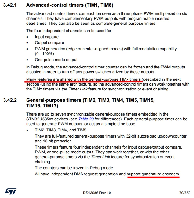

I am trying to use the quadrature encoder mode of the TIM in the STM32U585VITx, for positioning purposes of a stepper motor movement.
According to DS13086, page 79, the general purpose timers (TIM2, TIM3, TIM4, TIM5, TIM15, TIM16, TIM17) support quadrature encoders.
However, according to RM0456 Rev 5, page 2083, TIM 1.8 has support for quadrature encoders.
Could you please clarify which TIMs support this encoder?
Also, I am currently trying to use TIM8 for this purpose (not sure if it is the right timer), but when I move the motor and read the timer, I just get a bunch of zeros.
Any help would be greatly appreciated,
Thank you
It also says that TIM1 & TIM8 share many features with the GP Timers - so that could include encoder support
The datasheet is really just giving a quick overview - the Reference Manual gives the complete description

Thanks for your quick reply Andrew,
But just saying "Many features are shared with the general purpose TIMx timers" is not enough for me.
Also, on the 2nd page of the DS13086 it says that only two of the timers support this feature:
Up to 17 timers and 2 watchdogs:
- 2 16-bit advanced motor control
Which I think is inconsistent with the explanations in 3.42.2.

waclawek.jan
October 21, 2024
Well that's not true, partially because ST's nomenclature is not quite right.
TIM15/16/17 are not the same kind than TIM2/3/4/5 (which in turn form 2 groups themselves, 16-bit and 32-bit) and they don't have encoder mode.
As @Andrew Neil said above, the definitive guide here is the Reference Manual - for each timer, have a look at its TIMx_SMCR.SMS description - if it does have encoder mode, it is listed there.

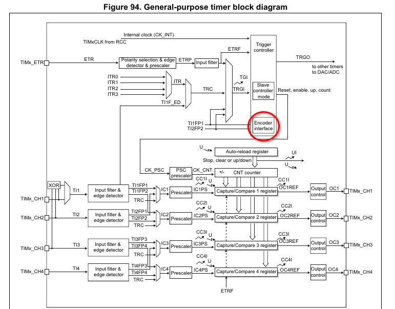

You can also look at the Timer diagram.
Also, the TIMx_ARR register needs to be set to a non-zero value for it to count... Usually, set it to max 0xFFFF (16 bit), or 0xFFFFFFFF (32 bit)...

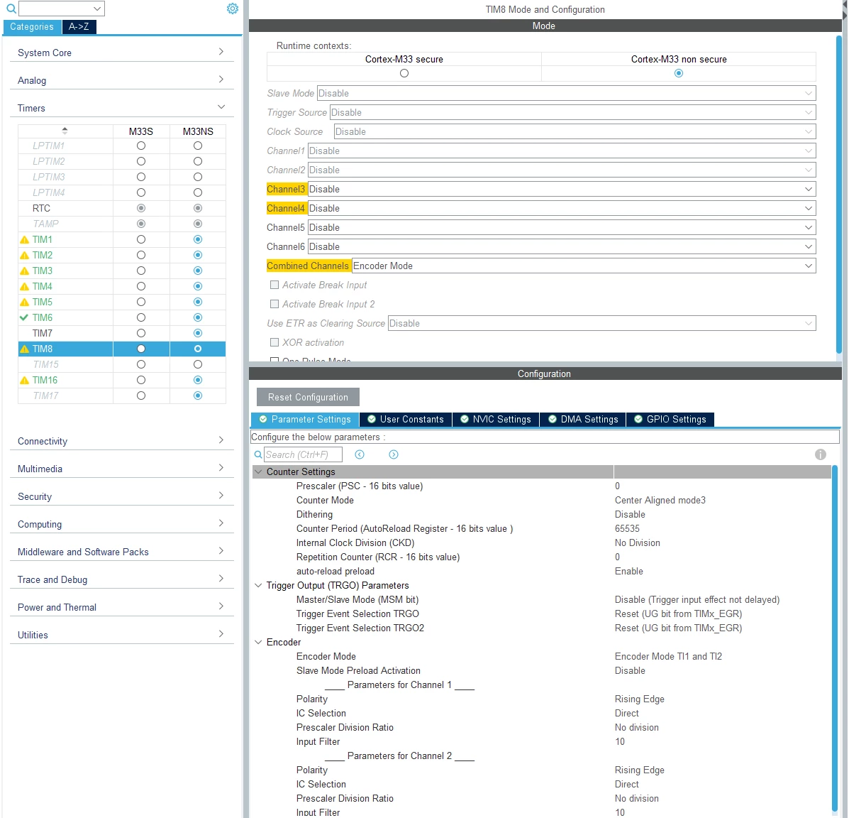

I am using STM32CubeIDE to configure TIM. I have posted my settings here. I have also included the auto generated tim.c. I have also tried to add some user code to this file, but no difference and I still get a bunch of zeros when I read the encoder like this:
uint32_t motor_ctl_get_encoder_value()
return (uint32_t)htim8.Instance->CNT;

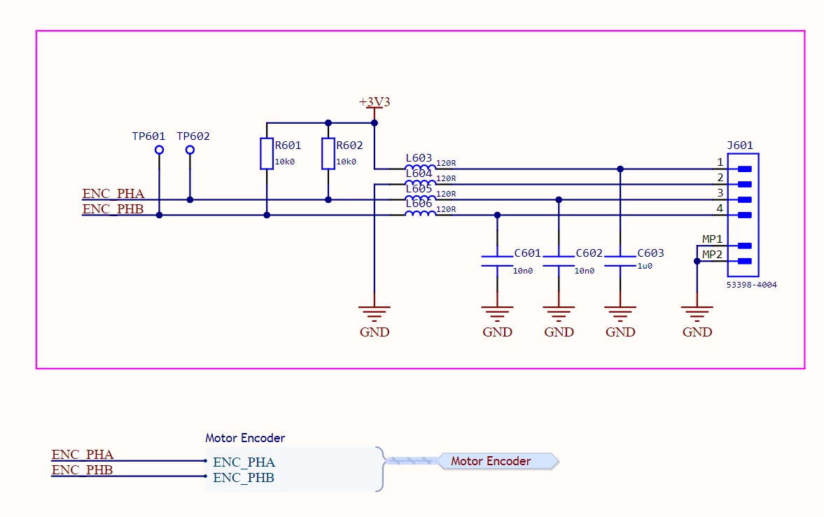

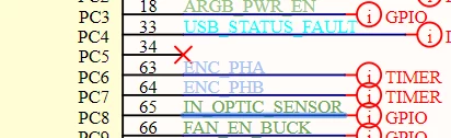

Thank you Andrew,
I attached that part of schematic. Pins numbers 63, 64 of the MCU are used for this.

Read out and check/post content of TIM and relevant GPIO registers content.
By reading out GPIOx_IDR check, if the respective bits are toggling when you turn the encoder slowly.
PS>
htim8.Init.CounterMode = TIM_COUNTERMODE_CENTERALIGNED3;
This should be ignored in Encoder mode; but for good measure, set it to default ("edge aligned", I don't know what's the Cube parlance for this).
ElhamAuthor
October 23, 2024
Thank you for your suggestion,
I checked GPIOx_IDR and there is no change there while motor moves.
waclawek.jan
October 23, 2024
Unless those pins are set as Analog by some mistake, you then have some electrical problem beyond the STM32.
Start with observing the encoder outputs using preferrably oscilloscope, proceed with checking continuity up to the mcu pins.
