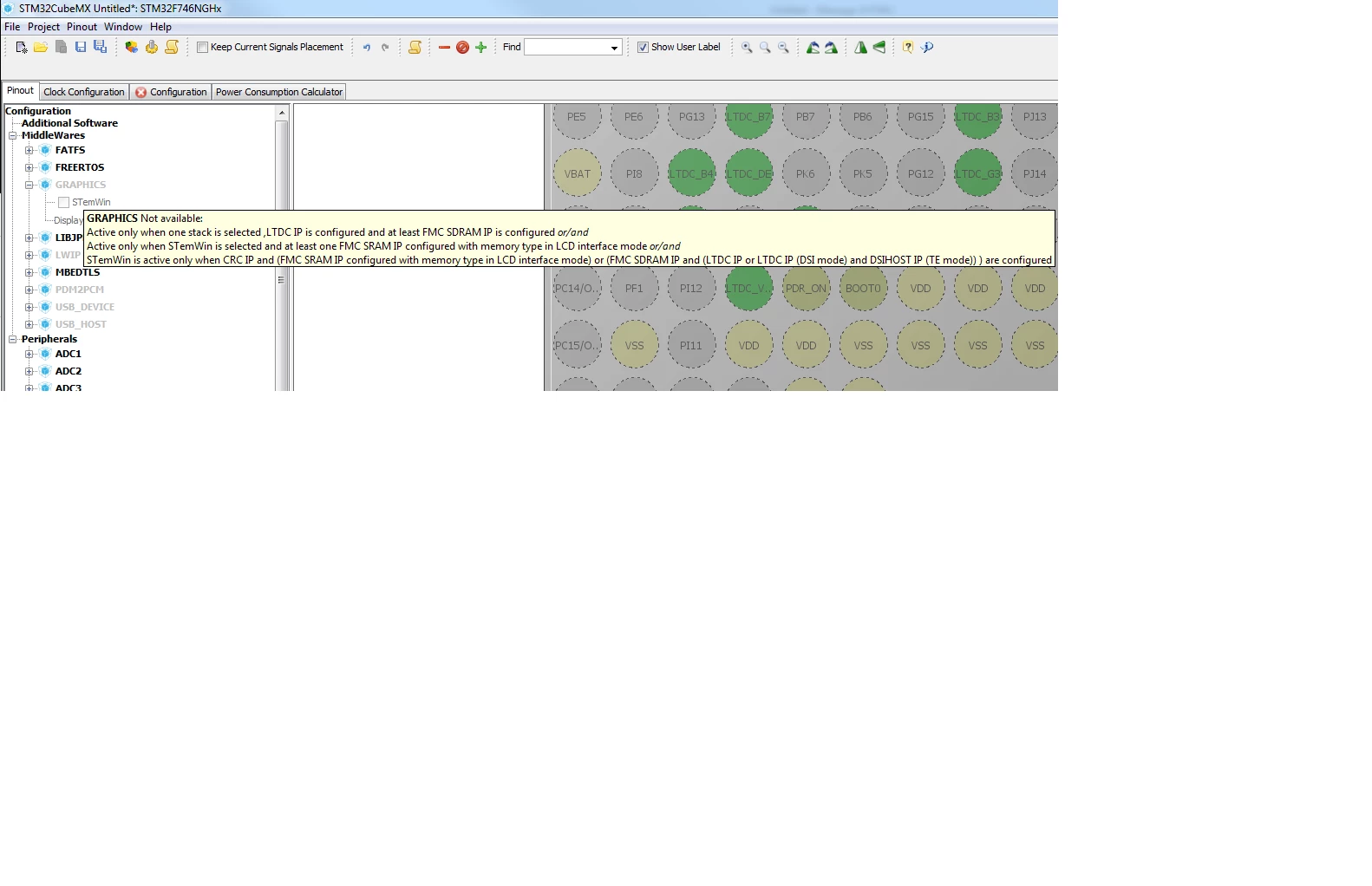

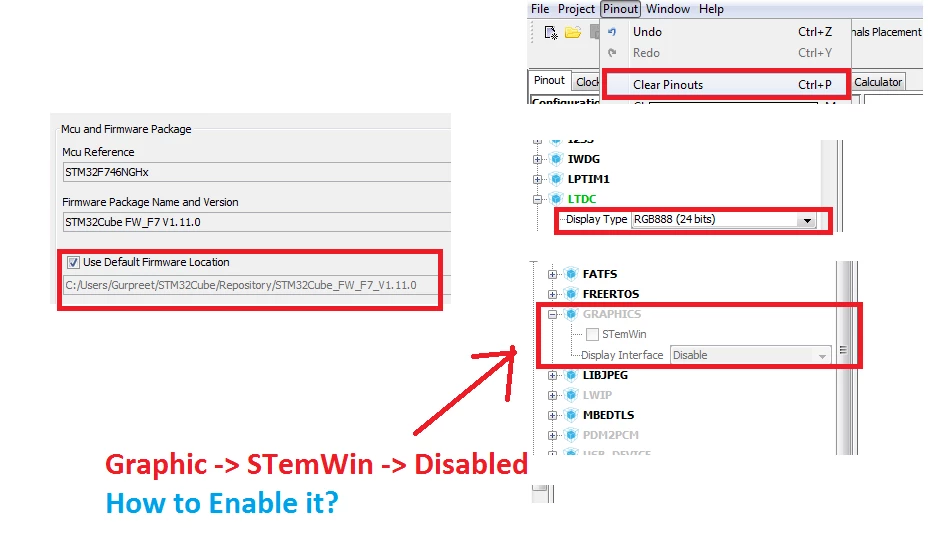

    I am trying to use STemWin with STMCube . But doing below steps .
    Still Graphic is disabled . How to enable it ? What I am missing ?

    September 3, 2018
    Hello @Community member​ ,
    To enable the Graphic and active STemWin on STM32CubeMx, you should follow the instruction in the warning: active CRC and FMC..
