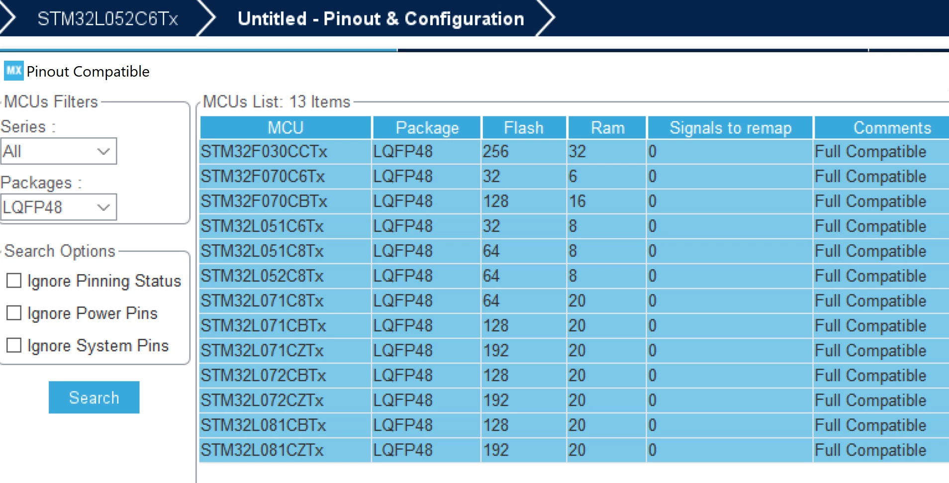

Which processors are pin to pin with STM32L052C6T6
Hello
I designed a card with STM32L052C6T6 mcu, but I can't find this mcu in Turkey.
What would you recommend as a pin to pin instead..
I found stm32f103c8t6 but if anyone else please advise

https://community.st.com/s/article/how-to-find-compatible-devices-for-an-mcu-stm32g473cb-as-example

CubeMX has a method to find matching parts.
Free stock at an of the "distributors" is pretty non-existent at this point there is a significant depth of pending orders on a very wide range of semiconductor parts. Microchip is quoting me 52+ weeks on a couple things I was looking at..
From an STM32 perspective the 144-pin LQFP tend to have the broadest compatibility.
One can probably spin a PCB quicker than you can locate parts in quantity

The List Pinout Compatible MCUs feature of CubeMX is useful here.
There are a lot more results if you ignore power pins. Presumably it treats VDD and VDD_USB as different.

How to enter there​
Operi.1
Operi.1Author
September 7, 2021
thank u so much solved
