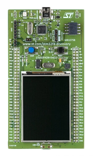

Hi.

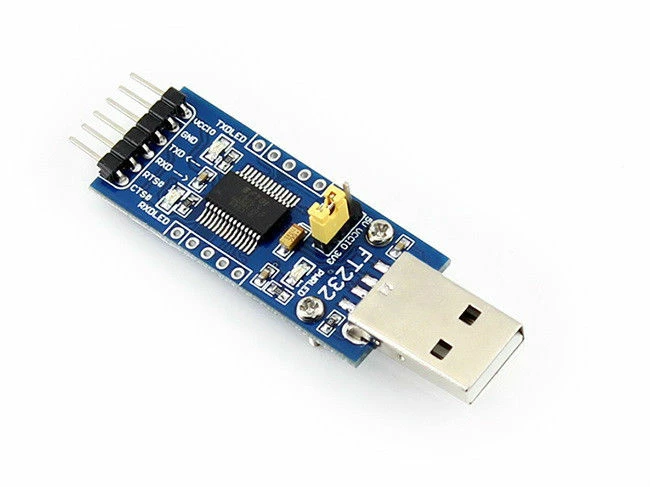

I'd like to test UART in STM32F429-DISCO kit, and I buy UART to USB board
But I don't know what pins are using in UART test with .STM32F4xx_DSP_StdPeriph_Lib_V1.8.0
Could you please let me know which pins should I have to connect between
STM32F429-DISCO kit and UART
 to
USB
 board ?

    There is a pin list on page 20 of the User Manual
    http://www.st.com/content/ccc/resource/technical/document/user_manual/6b/25/05/23/a9/45/4d/6a/DM00093903.pdf/files/DM00093903.pdf/jcr:content/translations/en.DM00093903.pdf

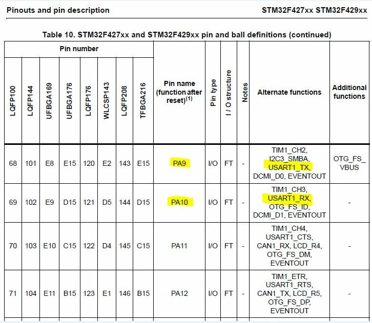

    Isn't USART1 connected to the VCP on the DISC1 board? via PA9 and PA10
    SB11 and SB15 control connectivity there. These could be removed and signals would be available at the headers.
    USART1_TX going to the RX pin of an adapter.
    Some free pins seems to be PD5 USART2_TX, PC11 USART3_RX, PC12 UART5_TX, PF6 UART7_RX

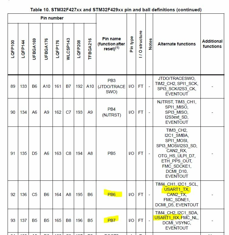

    I'm actually confused that manual saying USART1_TX : PA9, PB6 , and USART1_RX: PA10, PB7.
    How am I supposed to know which pin is used for USART1 TX,RX.
    Even the example code does not use alternate mode. how do we know which function does it use after reset.
    What I mean is for example PB6's function is defined as TIM4_CH1, I2C1_SCL, USART1_TX,CAN2_TX...
    Here 's example code of USART, I can't see the any information of alternate mode.

    The function can be multiplexed to multiple pins. The pin basically contains a sixteen way switch which controls which peripheral uses the pin. The secondary table in the Data Sheet describes these with AF0..15 settings.
    The code to configure the pins would be under STM_EVAL_COMInit()
    The pin via GPIO_Init(), the function via GPIO_AFConfig()
