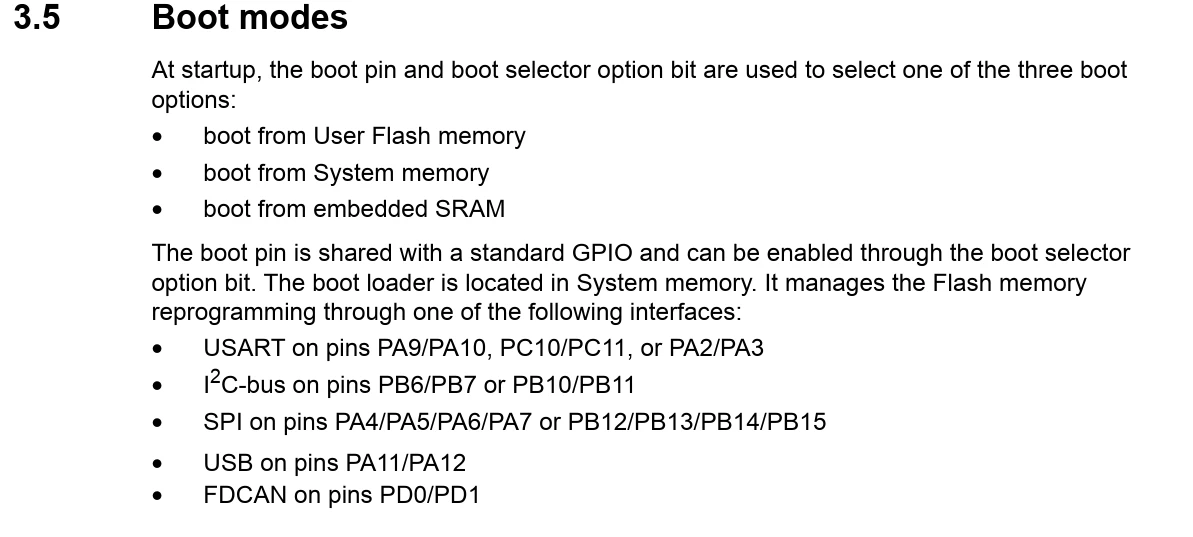

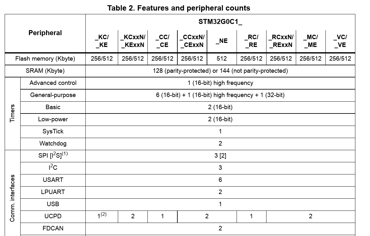

1. In the STM32G0x1 reference manual I can read about the FDCAN peripheral. But there is no STM32G0 MCU with FDCAN anyway. Why is FDCAN in this reference manual anyway?
2. How can I know whether a MCU has DFU (USB bootloader)? There's no column for that in the product selector and  - obviously - I can't know it for sure from the datasheet or reference manual (see 1)?

>1. STM32G0C1xC
so 2 CAN - right ?

I think USB-DFU is fairly universally supported, but obviously it's not in all parts since some don't have USB support anyway. You could look at AN2606, which organizes information about the bootloader across all STM32 families, you should find what you need there. Obviously, there might be missing information, but I think you will find it useful anyway.

Check in the reference manual in "1.4 Availability of peripherals"

In 'G0 family, only'G0Bx/'G0Cx (which is the same for with disabled/enabled crypto) have USB at all, so there is no point in checking USB/DFU bootloader in other models (as been said, in AN2606).
