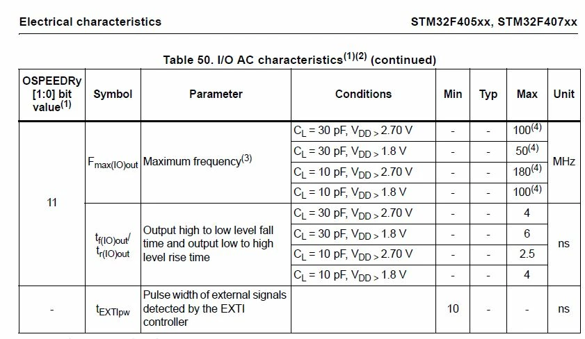

Vangelis Fortounas
April 26, 2019
Hi
This is STM32F405 Datasheet.
Uwe Bonnes
Chief
April 26, 2019
Vangelis: Switching speed != toggle speed. However toggle speed depends on coding style.
Abdiel: Can you perhaps use a timer for your task?
https://jeelabs.org/2018/toggling-io-pins/ talks about 84 Mhz toggle speed on a 168 F4.
Vangelis Fortounas
April 26, 2019
Hi.
It was not my intention to show switch speed but max freq. (i miss to highlight the Max freq)
100 MHZ has 10ns toggling time. STR instruction executes in one cycle so it is possible to produce the 100 MHZ/2 freq by write to ODR directly.
MBo�?.7
MBo�?.7Author
April 26, 2019
Ozone: Hm, wouldn't a RTOS include a lot of other stuff which are run in the other threads? Which would then mess up my timely critical function? Like I wrote, we need a deterministic code with ability of pin to be toggled below 25ns. When pin should be toggled no interrupt or other work can be executed because if it does, our code goes out of sync. We don't have experience with RTOS and we don't have problems with mili seconds, we need precision in nano seconds.
Vangelis: The best I can do currently on STM32F407 when switching pin from hi to low is 41ns, that would be around 24MHz... Guess I look into it more!

Vangelis Fortounas
April 26, 2019
"that would be more than enough!"
But not by software. . By software you can produce maximum 168/2 = 84MHZ (12ns) for a limited number of cycles by continuously writing STR instructions (assembly). And no Wait States, Interrupts, Power optimizations, etc
