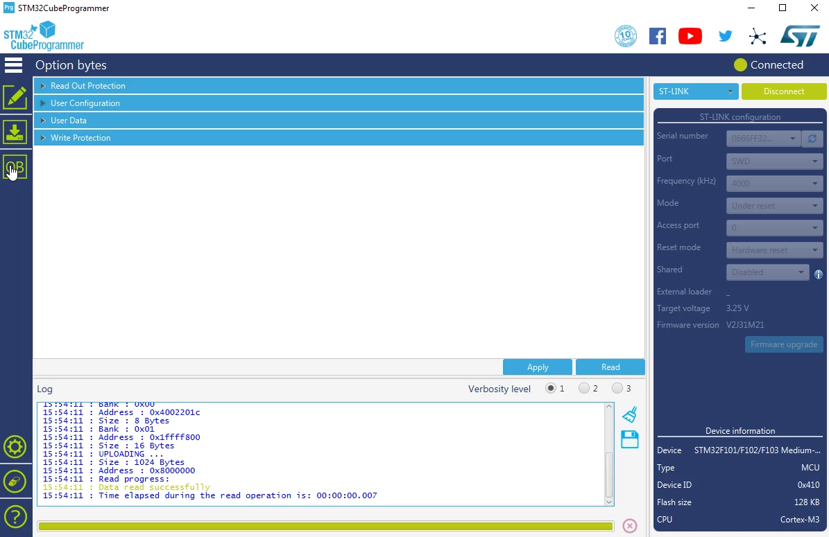

Which is the BOOT1 pin in STM32L0? Don't find in the pin description.
According to the ST boot mode selection (page 236), we can activate the bootloader following the pattern: Boot0(pin) = 1 and Boot1(pin) = 0; but the DatasheetSTM32L0 doesn’t specify which one is the BOOT1 pin in the pin description (page 33). I could only find the BOOT0 pin.

You can modify the BOOT1 state by using the option bytes.
  1. connect your device to the Cubeprogrammer
  2. select the option byte button "OB" like this :
then you can modify BOOT0 and BOOT1 according to your needs.

Boot1 is some Option Bit.

berendi
Principal
Apr 15, 2020 2:05 PM UTC
It looks like an error in AN2606.
Option bits are non-volatile configuration bits that control booting and security features. Read about them in chapters 2 and 3 of the reference manual.

FBIZA.1
FBIZA.1Author
Apr 15, 2020 4:44 PM UTC
Thanks a lot for your clarifying answer!
