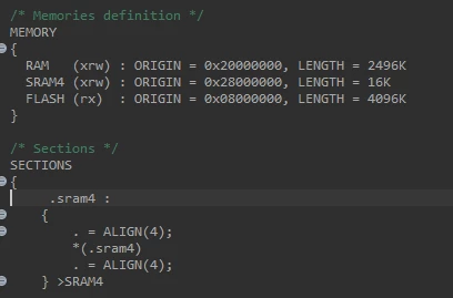

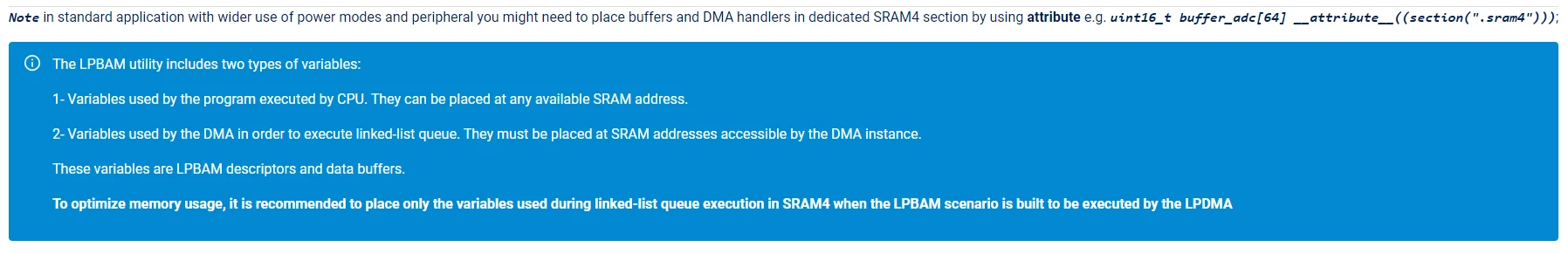

Hello @AKova.3
Ensure that your linker script correctly defines the SRAM4 section and that it is properly mapped (you could share it)
Only data/ variable used by DMA need to be defined in SRAM4, no other code parts are needed

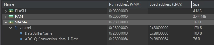

I have a simple application with one queue which has one ADC conversion data block inside. The conversion is triggered by LPTIM1 which I start and stop manually. After 50 samples I expect a transfer complete interrupt. The queue is not run in circular mode. While the ADC data is being sampled the device is in STOP2 mode.
The relevant part of the linker script is
I have placed the buffer where ADC samples are transfered to and queue descriptor variable in SRAM4 as seen in the build analyzer
The variable ADC_Q_Conversion_data_1_Desc is of type LPBAM_ADC_ConvDataDesc_t. This is the only variable of that type. I am working on NUCLEO-U5A5ZJ-Q board. Under these conditions my application won't run after I power cycle the board.
