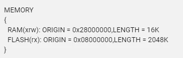

In this document there is the following statement:
To do so, In the STM32CubeIDE, in Project Explorer > Debug, go to the STM32U575ZITXQ_FLASH.ld and configure the RAM ORIGIN = 0x28000000 and the LENGTH = 16 Kbytes
The consequence of this is that I only have 16 kbytes of RAM available for this project.
Is that right?
Is there another way to use the remaining RAM?
