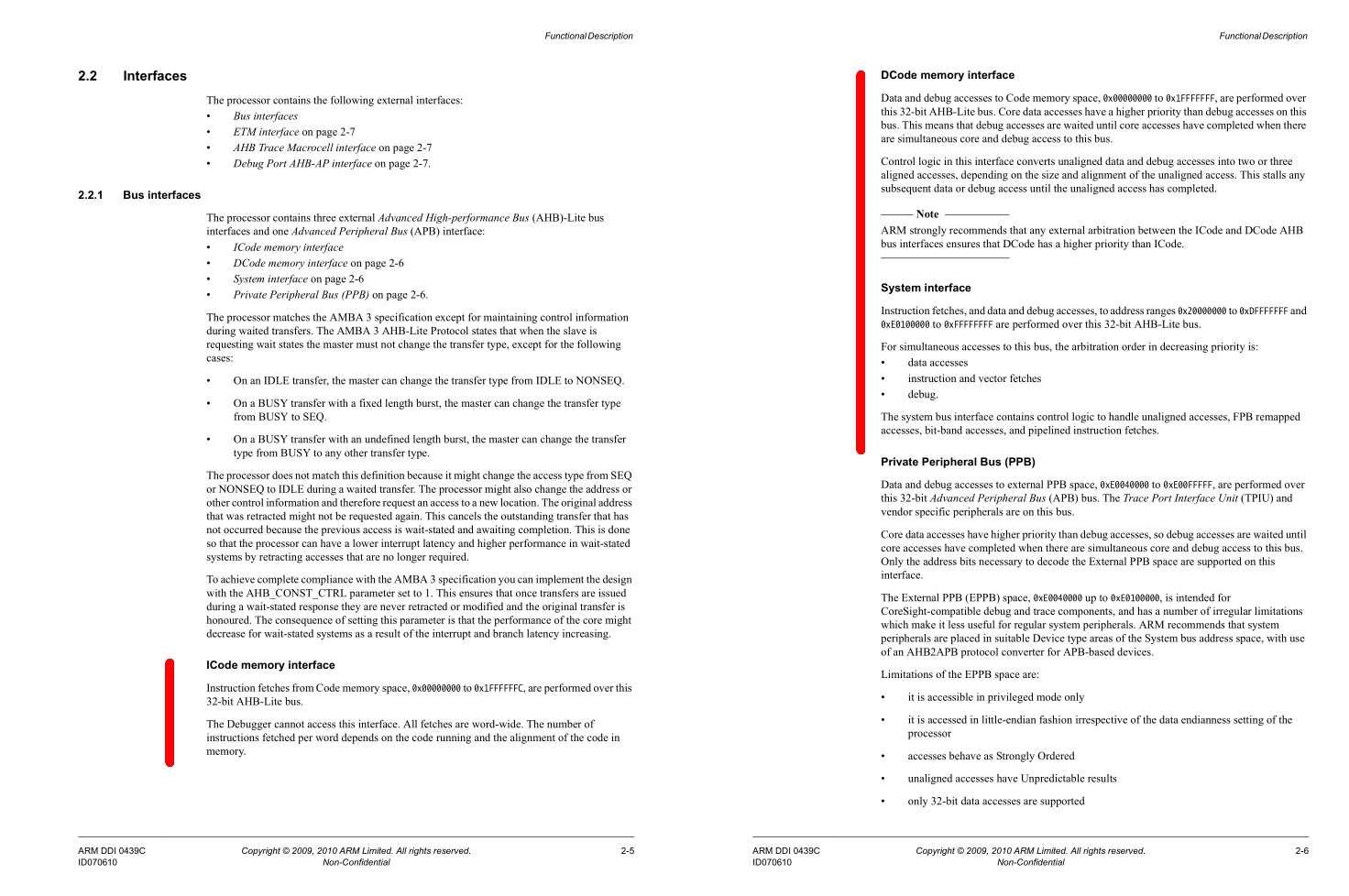

Which Bus is used to access memory addresses such as 0x0020000, 0x0010000 & 0x08000000 in STM32L4R5ZI controller?

Uwe Bonnes
Chief
December 7, 2021
In my understanding, everything below 0x2000 0000 is fetch by the instruction bus.
