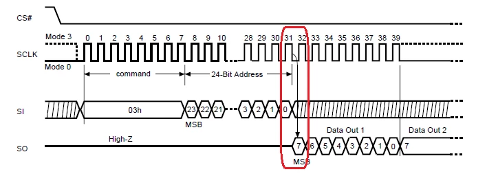

There is a STM32F407 on my board to configure and control the optical module. Also, STM32F407 use SPI to interface with CPU. STM32F407 work as SPI slave mode, and CPU work as master mode. Some protocol require one flow control byte in SPI timing, such as OIF protocol. My understanding is :
For read operation. After slave receive the operation code and address, slave need time to prepare data according to address then put the data into TX_Buffer. This all will be finished in the one clock period as below red mark shown. If slave can't finish the job in time, slave must inform to host through flow control byte .
My question is whether flow control byte is needed in the SPI frame for STM32F407?or it can mitigate this issue through reducing the SCK frequency, not through flow control byte?
Thanks in advance!
Whether it's needed or not has nothing to do with the STM32.
If the STM32 is communicating with a device which uses it, then the STM32 will have to handle it!

Sorry that I confuse you. I only care about SPI interface between STM32F407 and CPU, and just mention the optical module. You can ignore optical module. Yes, for SPI interface between STM32F407 and CPU, STM32F407 work as slave mode and CPU work as master mode. My concern is that whether STM32F407 could handle data during one clock period? If not, flow control byte is needed or reduce the frequency of SCK for mitigating it?
The format of flow  control byte is below:
0x00: ACK, slave could handle this access, and next byte transmitted is data
0xFF:  NACK, slave couldn't handle current access, and next byte transmitted is flow  control byte too.
If CPU support flow control function and support it into the SPI  timing, STM32F407 also must support flow control function. And vice versa.
Thanks in advance!
That's going to depend very much on your system - impossible to give a general answer.
I'd say the safest way forward is to assume that it won't, and design-in support for this "flow control".
Then you won't get any nasty surprises...

Thanks! The mystery "CPU" is Intel Xeon D1627 :).
SPI of MCU is driven by software, and it don't like some peripheral device which use hardware circuit to drive SPI interface. So, I will add this flow control byte firstly according to your suggestion.
