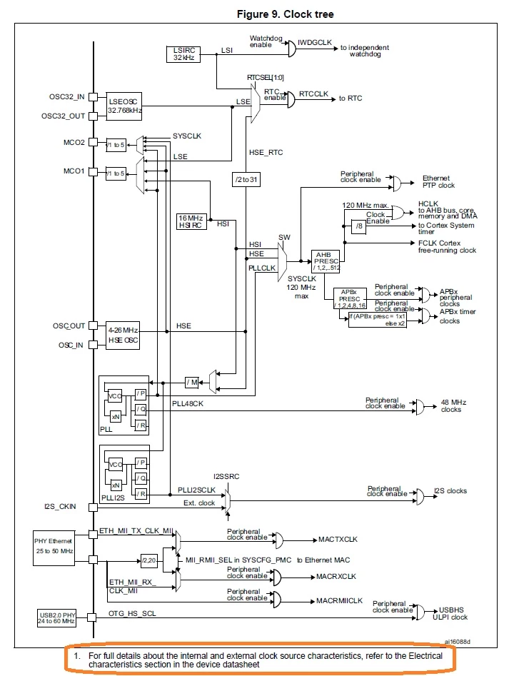

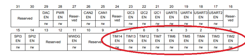

There is typical a Clock Tree diagram, a diagram of which TIM/peripherals are on which bus, and the RCC_APBxENR registers also infer which TIM is on each bus based on which bus clock that needs to be enabled.

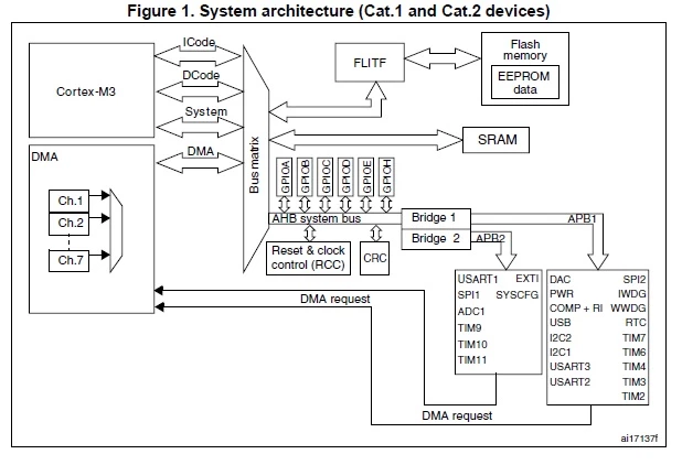

Arbitrary timer A... WHERE is diagram showing which peripheral is on which clock tree?
I just found the timer clock sources in tabular form in the datasheet (not in reference manual where I searched).
Next stop - is a #define for the timer clock frequency output by the CubeMX tool for each timer?

ST likes diagrams for the kidz that can't read good and stuff, here from a Reference Manual for an arbitrary STM32 part.

Guru
Oct 23, 2018 3:34 PM UTC
Other STM32 parts, where the RM covers a few dozen varied ICs, you get referred to the DS
but also
Dave Nadler
Senior III
Oct 23, 2018 3:36 PM UTC
Yup, missed that bit in the Device Overview block diagram...

CubeMX can show the clocks tree very nicely, if you use it.
/* Some time ago there was a request to display the clock and frequency info in CubeMx GUI for timers, to save users time from digging in the manuals ... but given the overall situation, I'm not holding my breath */

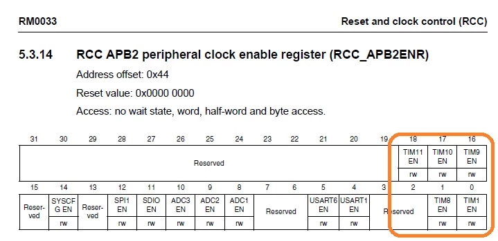

Hi @Dave Nadler​ ,
You may have a look on "RCC_APB1ENR" and "RCC_APB2ENR" registers in the reference manual.
Example: "RCC_APB1ENR " register shows the peripherals connected to the APB1 bus (screenshot taken from STM32F2 RM).
Khouloud.

PA, the nice clock diagram in CubeMX does not show which timers are on which clock, which was the original question. In the reference for the particular part I was looking at, the information was not in the RCC section nor the timer section, nor is there an "interconnection section". But it is in the datasheet, and in the overview block diagram. Thanks JW and Clive!
