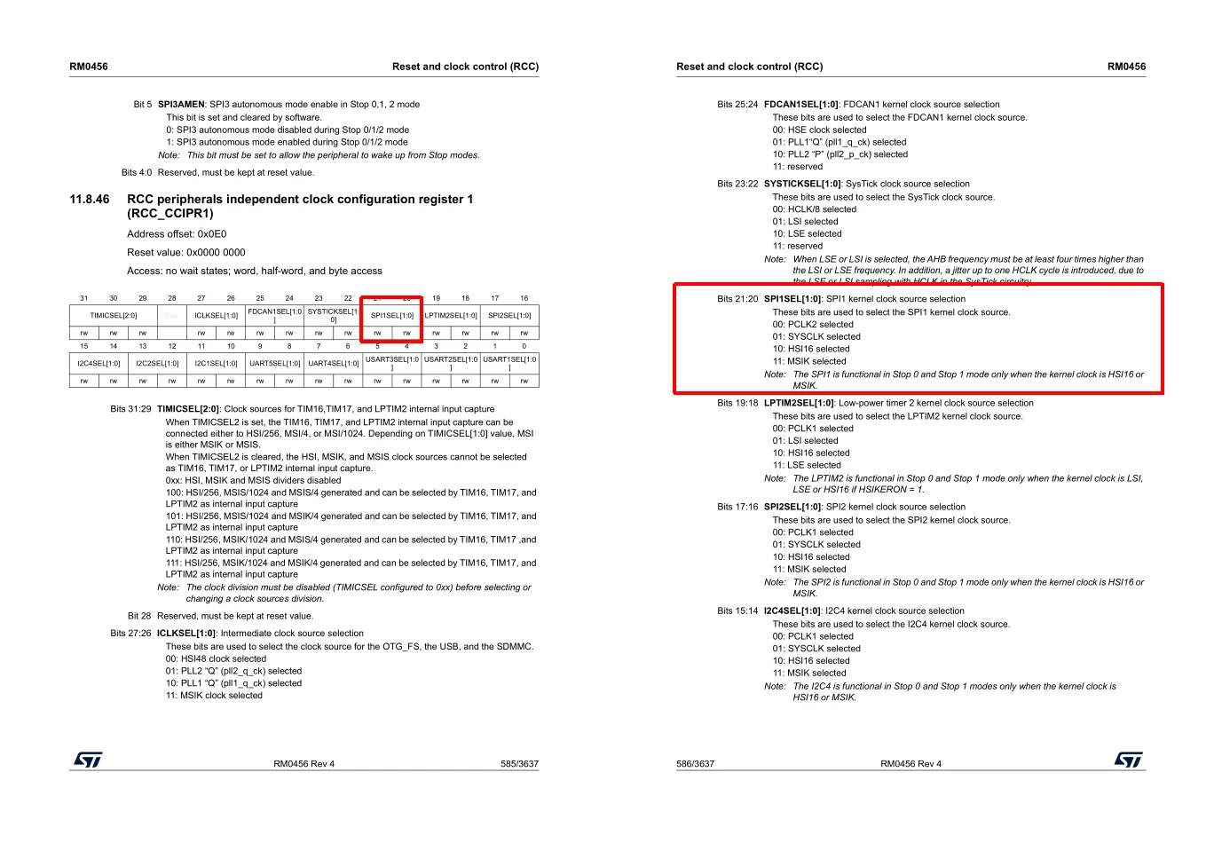

Where is the STM32U585 SPI1 CLOCK SELECTION register?
According to the STM32U585 documentation, there is supposed to be a SP1 clock mux selection register, but none is described in the latest programming manual.
Does anyone have any idea on what bits I need to set in which register to select the MSIK clock for the SPI1 peripheral?

0693W00000aJiaFQAS.png?

Great, thank you! Exactly what I needed.
