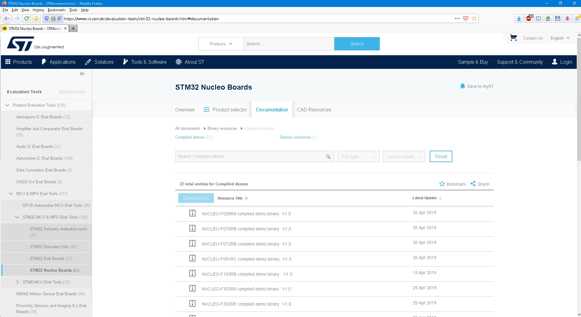

(can't give link as ST's web designers indulge in excessive javascripting).
Yes, you are right, it is not there.
