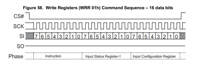

In the data sheet it is given that, CS# pin should be low until command instruction 16bit data will pass. as shown ablove.

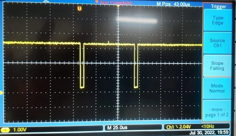

but when executing command the CS# Pin perform HIGH-LOW_HIGH and again did the same thing at the timing of writing. this should not happen. asper data it low at command insertion and data writing.
ihave check ON CRO.

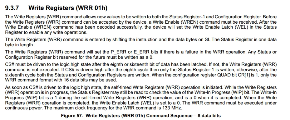

For enabling the QSPI mode, you need to set QEN bit of configuration bit and for that you have to send write enable command followed by 16 bit value of status register and configuration register. In that sequence CS# should be low.
given in data sheet. i have attached screen shot0693W00000QMWw0QAH.png0693W00000QMWw5QAH.pngbut when I write code for enabling command given below

the CS# pin get two time HIGH_LOW sequence, where in datasheet(screen shot above) it should be done in consecutive.
CS# pin screen shot for enterQPI mode.0693W00000QMWwAQAX.jpgi think because of this i am not getting proper result, so if I manipulate CS pin, result would be proper. correct if am wrong .
