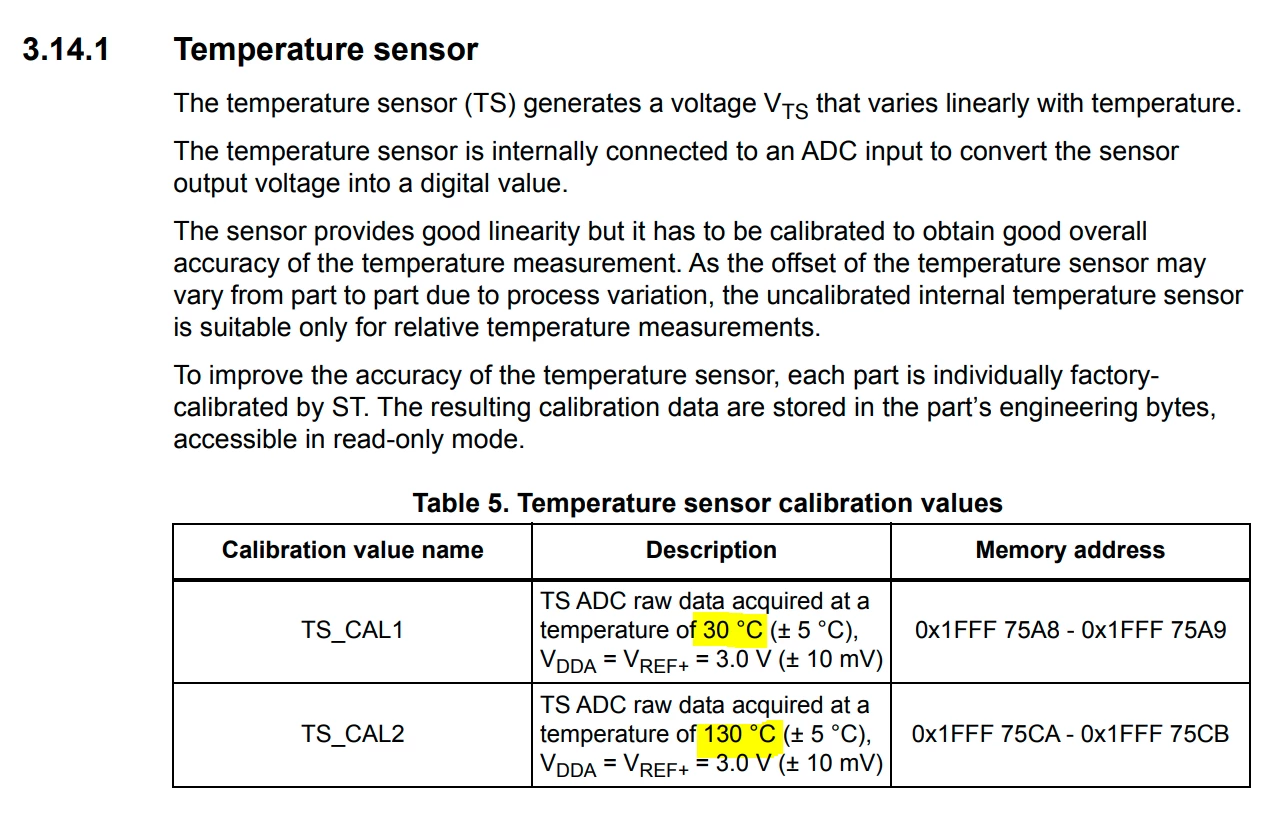

So I need to find TS_CAL1, TS_CAL2, TS_CAL2_TEMP, and TS_CAL1_TEMP
I go to DS12992 Rev 2 Page 24 Paragraph 3.14.1:
The temperature sensor (TS) generates a voltage V TS that varies linearly with temperature.
The temperature sensor is internally connected to an ADC input to convert the sensor
output voltage into a digital value.
The sensor provides good linearity but it has to be calibrated to obtain good overall
accuracy of the temperature measurement. As the offset of the temperature sensor may
vary from part to part due to process variation, the uncalibrated internal temperature sensor
is suitable only for relative temperature measurements.
To improve the accuracy of the temperature sensor, each part is individually factory-
calibrated by ST. The resulting calibration data are stored in the part’s engineering bytes,
accessible in read-only mode.
Table 5. Temperature sensor calibration values
Calibration value name Description Memory address
TS_CAL1
TS ADC raw data acquired at a
temperature of 30 °C (± 5 °C),
V DDA = V REF+ = 3.0 V (± 10 mV)
0x1FFF 75A8 - 0x1FFF 75A9
TS_CAL2
temperature of 130 °C (± 5 °C),
0x1FFF 75CA - 0x1FFF 75CB
So two of the 4 values I need are given in the documentation.

TDKBest answer
February 15, 2022
From the datasheet, it tells you the temperature at which those values are acquired:
So TS_CAL1_TEMP = 30 and TS_CAL2_TEMP = 130, which is exactly how they're defined in the LL library.
https://github.com/STMicroelectronics/STM32CubeG0/blob/c6c0046d9278a7107261c6bf38327345df4c3efd/Drivers/STM32G0xx_HAL_Driver/Inc/stm32g0xx_ll_adc.h#L252
TEMP_DEGC_CAL1 and TS_CAL1_TEMP are equivalent and it should be corrected to use only one name.

No it is around 30C and around 130C They say +/- 5C. If they are off by 5 C then it is not calibrated. They need to tell the exact temperature they calibrated it at. not +/- 5C
February 15, 2022
I'm not arguing with you regarding accuracy, but that's not how it's implemented. "Calibrated" is relative. If you need better precision than the datasheet specifies, you'll need to calibrate yourself.

February 15, 2022
Thanks for the pointer to the names that they used which is different again from the documentation and comments in the same file.
/* Temperature sensor */
#define TEMPSENSOR_CAL1_ADDR ((uint16_t*) (0x1FFF75A8UL)) /* Internal temperature sensor, address of parameter TS_CAL1: On STM32G0, temperature sensor ADC raw data acquired at temperature 30 DegC (tolerance: +-5 DegC), Vref+ = 3.0 V (tolerance: +-10 mV). */
#define TEMPSENSOR_CAL2_ADDR ((uint16_t*) (0x1FFF75CAUL)) /* Internal temperature sensor, address of parameter TS_CAL2: On STM32G0, temperature sensor ADC raw data acquired at temperature 130 DegC (tolerance: +-5 DegC), Vref+ = 3.0 V (tolerance: +-10 mV). */
#define TEMPSENSOR_CAL1_TEMP (( int32_t) 30) /* Internal temperature sensor, temperature at which temperature sensor has been calibrated in production for data into TEMPSENSOR_CAL1_ADDR (tolerance: +-5 DegC) (unit: DegC). */
#define TEMPSENSOR_CAL2_TEMP (( int32_t) 130) /* Internal temperature sensor, temperature at which temperature sensor has been calibrated in production for data into TEMPSENSOR_CAL2_ADDR (tolerance: +-5 DegC) (unit: DegC). */
#define TEMPSENSOR_CAL_VREFANALOG ( 3000UL) /* Analog voltage reference (Vref+) voltage with which temperature sensor has been calibrated in production (tolerance: +-10 mV) (unit: mV). */
