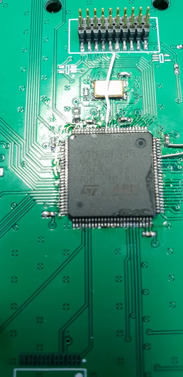

Where is pin Nr 1?
On this picture, which is the pin Nr 1?
Top right or bottom left ?
Thanks
Julien

    Bottom Left (see Nucleo-144 Board), the top-right is the ejector mark from the mold.

    Chief
    Jan 2, 2019 11:41 AM UTC
    Look in the datasheet under Device marking. Normmally when the labels are readable like normal text, Pin 1 is bottom left

    JulienD
    JulienDAuthor
    Jan 2, 2019 2:26 PM UTC
    Ok, I always thought that labels were not a reliable way to identify pins.
    Btw, in CubeMX, it is a third orientation...
    I just need to unsoldier it.... :(
    Thanks.

    There have been previous threads where I've posted pictures. Different manufacturing sites have different equipment so there are usually a couple of variations in the plastic and printing or laser marking.
    I think the marking could be a lot move obvious and consistent.
