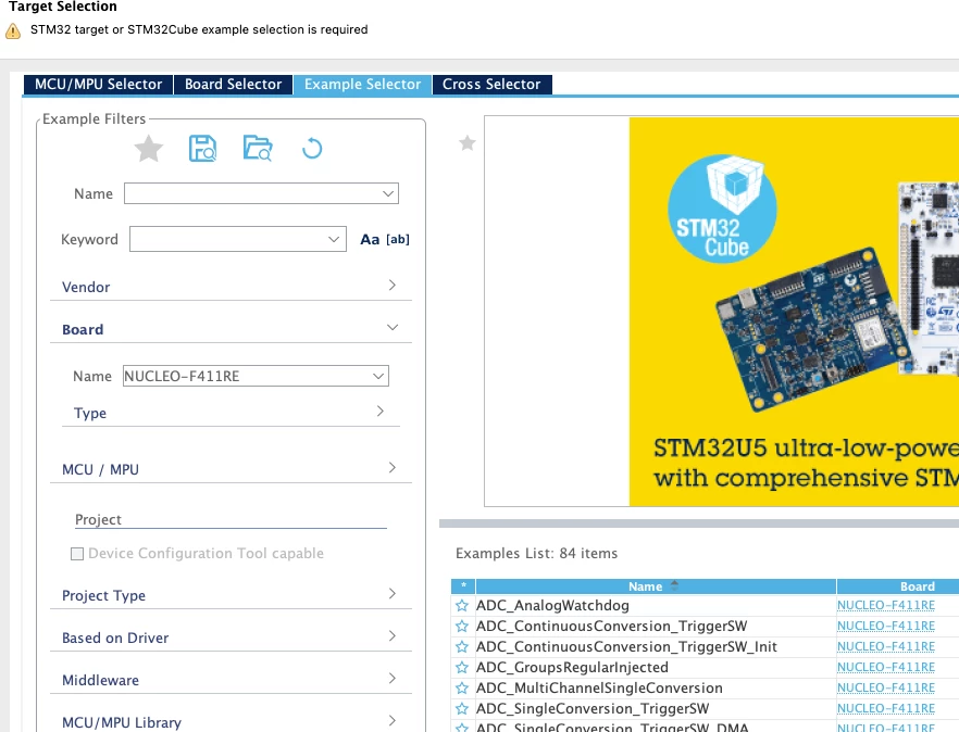

The "helpful" link in the getting started guide says it is available on www.st.com . Could someone be more specific? Thanks
Best answer by BerndAnton
the easiest way to get the example code is via CubeIDE (https://www.st.com/en/development-tools/stm32cubeide.html )
  • create a new project.
  • go to Example Selector tab.
  • search your board
=> on the bottom right you get a list with all examples.

Muhammed Güler
Senior III
May 10, 2022
https://www.st.com/en/embedded-software/stm32cubef4.html
sample software is available in the firmware package. After downloading the file or after you find it already downloaded on your computer, you can check the directory below.
\STM32Cube_FW_F4_V1.27.0\Projects\STM32F411RE-Nucleo

To the people who answered my original question, THANK YOU. Responses were helpful. I didn't know whether a thank you would be welcomed or would be viewed as a distracting piece of social fluff.
I went straight to Muhammed's answer and found much the kind of thing that I was looking for. I also noticed BerndAnton's response and saw the things he mentioned, in passing, as I was checking out Muhammed's leads.
I would have chosen either of these over the "selected as best" response, because the selected response does not lead to the software (firmware) that comes loaded into the board when you first receive it. That was what I was hoping to find. Instead, that destination seems to have fine points, tweaks, and updates - all of which may be excellent for customers who are already at home with ST's offerings, but is unfortunate for a novice. For a novice, that answer should have referenced the page, then indicated that you needed to install the Cube IDE and then rummage through the source tree, and perhaps mentioned a starting point, or a principle for finding an appropriate starting point.
