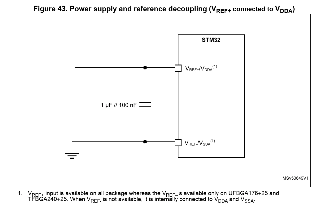

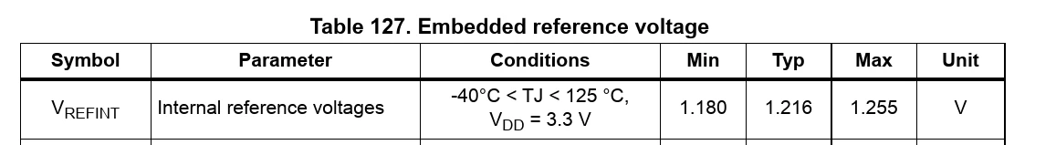

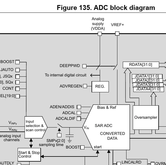

AScha.3
February 26, 2023
there are two "Vref" : the + reference of the sar adc and the internal reference source:
0693W00000aHfjtQAC.pngthis is what tried to explain.
int.ref.
0693W00000aHfkIQAS.pngand vref+ and vref- are on pins (or internal conn. to vdd/vss):
0693W00000aHfkXQAS.png0693W00000aHfkEQAS.png>cannot find where CubeIDE defines which reference voltage the ADC should have
because Cube cannot set, what voltage you supply to the pin (which is vref+)
ok now?
