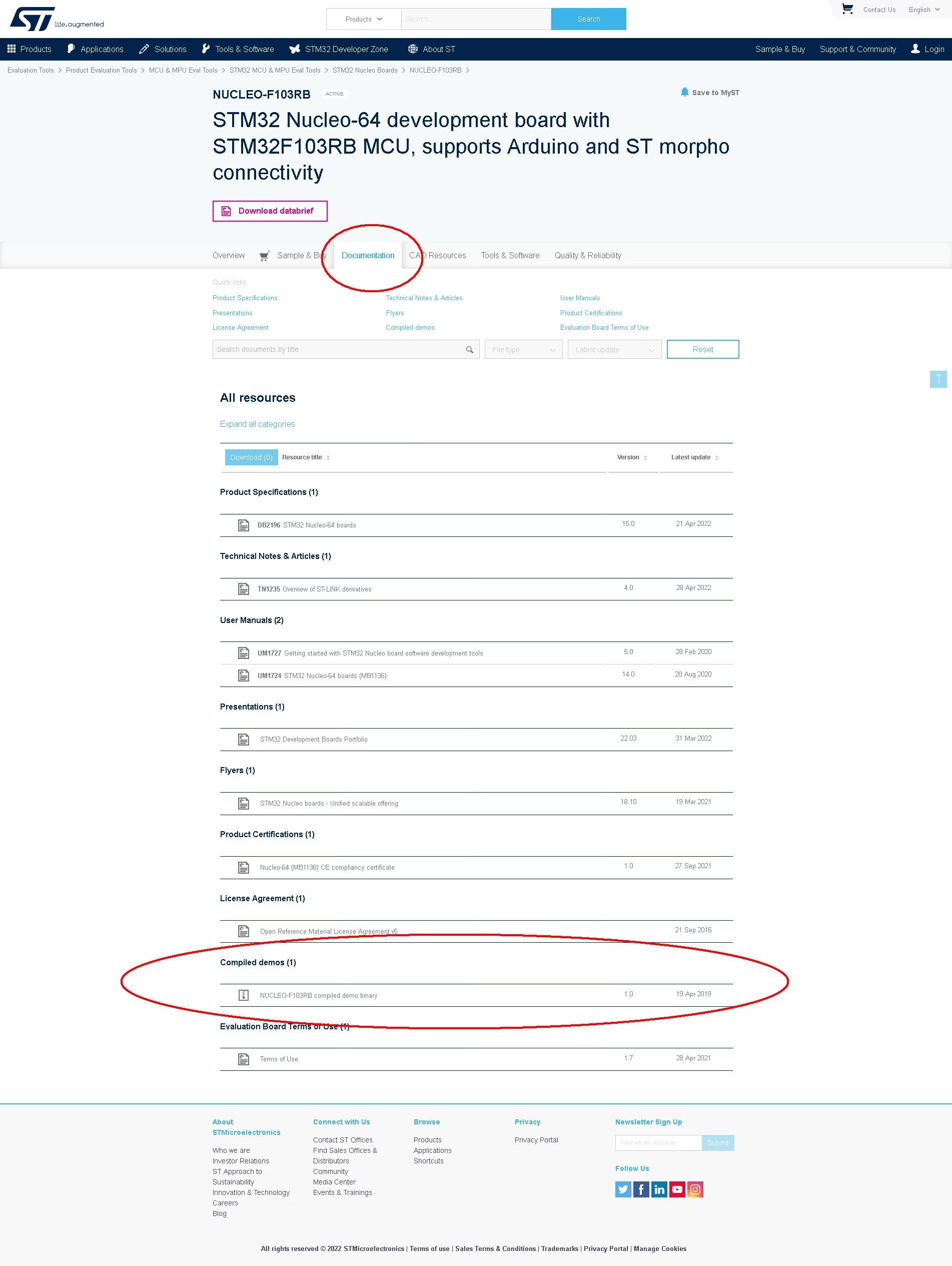

Where can I find the Nucleo F103RB demo binary?
I'm looking for the .bin file that comes pre-programmed on the board. Anyone know where I can find it? The .zip file on the product page appears to be for a different board/project and also only contains a .hex file. Also if there is source code is available for the project that would be helpful too. Thanks!

The original code which normally only blinks is confusingly big, because it's in fact a demo of an LCD "shield", and the blinking is only a minor part of it, see description .txt files.
https://github.com/STMicroelectronics/STM32CubeF1/tree/master/Projects/STM32F103RB-Nucleo/Demonstrations/Adafruit_LCD_1_8_SD_Joystick
